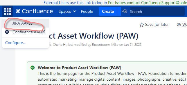

When the users click on the squares at the top left of the Confluence page, there is a link to go to JIra. The page they are taken to is a board in the old project, not in the new project. What needs to be changed so that when they click on the squares, then click on Jira, they are taken to the new project?
I am assuming you are referencing the Jira links that are at the top of the page. These are created when an issue is linked to a Confluence page. You would need to remove those links and create new links off of the issues in the new project. If that is not what they are can you please share a screenshot?
When the user clicks on this, she is taken to the board in the old project, not the new project. (Interesting though, when I click on my link, it goes to my own board, not the old or new user's board.) How do I change this link?
@Monica Collins Thanks for the screenshot. Those links are either an application link or are added through the application navigator. You will need to be a Confluence admin to change them. Information is below:
