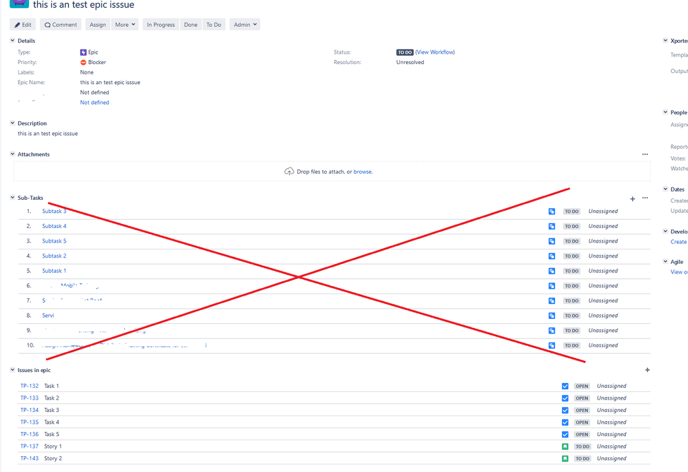

I have an automation rule where I need to create about 60 tickets when an EPIC is creating - i know is much but it's a process for us, we need to follow.
Our process is like that:
When an EPIC is created -> create 5 tasks-> then create 2 stories and about 20 subtasks under those stories.
I have two problems:

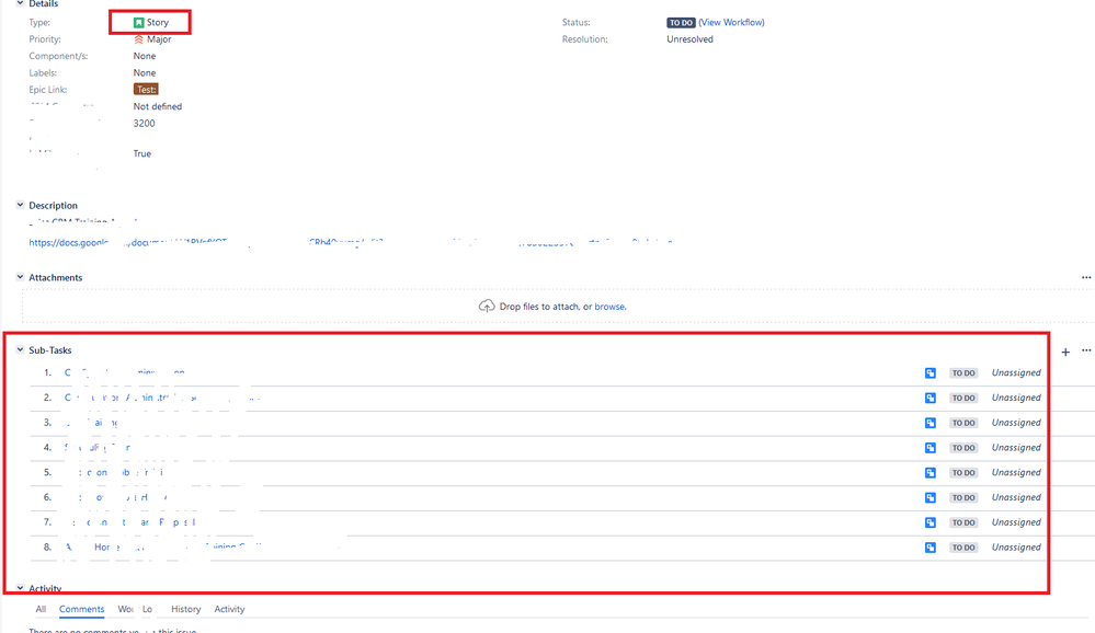

1) I don't want the subtasks to be displayed in the EPIC, just the "Issue in Epic". The sub-tasks should be just under story's. I want when i go into a story to see the subtasks there - every story has like 20 subtasks.
Is this even possible? Because manually i can do it. I want them to be displayed like this:
So subtasks to be displayed under story only.
2) How can i link the subtasks to the Epic - i want to have the epic link in subtasks also.
Thanks.

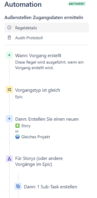

Sorry for the german wording, but you should be able to guess it.
The trigger is pulled when a new epic gets created manually. Then a new story gets created automatically. After the branch (for stories or other issues in the Epic), the sub-task gets created und der story and und within the epic.

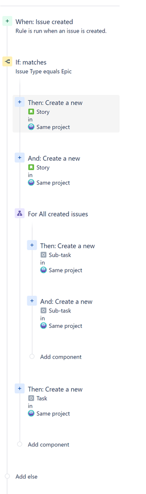

Hi @Albert Manuel , Based on the suggestion from @Bill Sheboy , here's what works for me.  Learnt that branching on all created issues doesn't trigger another separate automation execution.
Trigger: Issue created
Condition check: If issue type = Epic
Action: Create new Story (set Epic Link - Copy from trigger issue)
Branch: For all created issues
             Action: Create new Sub-task
Action: Create new Task (set Epic Link - Copy from trigger issue)

Ok, the  important thing here, which I think you already know, but haven't mentioned, is that sub-tasks and issues-in-epics are two totally different things.
A sub-task is part of its parent issue, completely, whereas an issue in an epic is an issue that is being grouped (usually with other issues) and flagged as being part of the epic.  The epic-link, which showing there is a relationship, is not saying that the issue is a part of the epic, just that there is a link.
So, that stated, your questions
1) In your screenshot of the Epic, you're showing sub-tasks as being part of the epic and you don't want that.  That's fine, but the simple answer is "don't create sub-tasks for the epic itself".  Jira doesn't care what the issue type of a parent is, and happily lets you create sub-tasks under issue level issues and Epics too.
To fix your issues, go into each subtask and change the parent from the Epic to the story that they should be a part of (when people have done this in the past, I've often seen them just create a new story and bulk-edit all the sub-tasks over to the new story)
2) Sub-tasks do not have an epic-link.  They are linked to an Epic only logically, by being part of an issue that has an epic-link.
This is a bit of a pain in Jira, because it's confusing for reporting purposes - I often find myself creating a custom-field called something like "Epic-all", which copies the Epic link in a story, and looks to a sub-task's parent for the Epic link there.  I think this should really be built-in, but hey, we're not there yet.

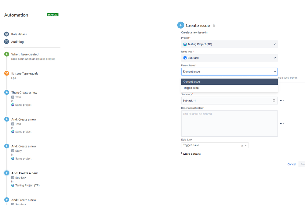

Call me crazy but looking at look at my settings i don;t see a way to change the subtasks to go under stories as you said, check my screenshot:nicscreen.png
Nic Brough -Adaptavist-
October 12, 2021
This automation rule has the wrong triggers on it - it's creating issues when the Epic is created, which is fine for stories, but the sub-tasks it tries to create are going to be under the current issue (the Epic) or the issue triggering the rule (also the epic).
You'll need to nest the sub-task creations under the stories you want them on, not on the Epic create.
The change I was talking about was for fixing your already created sub-tasks though, I wasn't looking at the automation.
