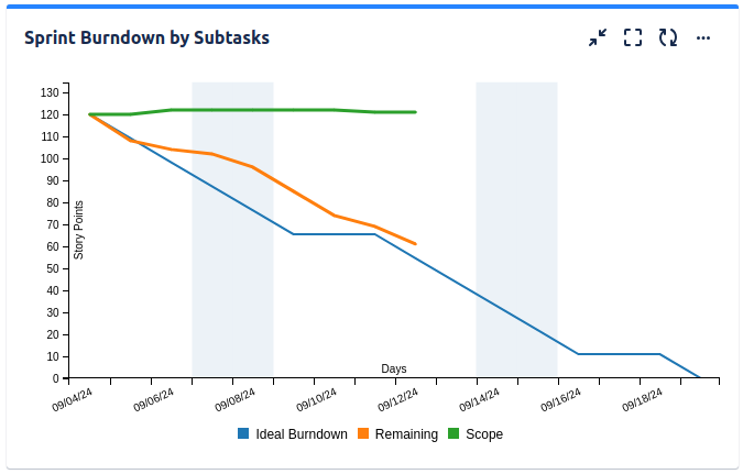

Tracking sprints by subtasks is not possible with the default Jira reports and gadgets.
But what you can do if you want to keep your existing project structure is to look for an app on the Atlassian Marketplace that can track sprints by sub-tasks.
If you're open to using an app, our Great Gadgets app offers a full set of gadgets for tracking sprints by sub-tasks: sprint burndown/burnup, team velocity chart, release burndown/burnup with forecast, etc.
If you need any assistance, please contact support@stonikbyte.com.
