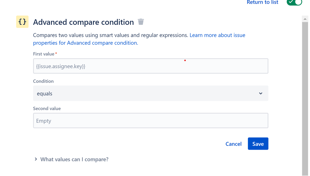

I want to use condition using automation to check the issue for particular project and workflow for the further transition so how can I get the name or id of a workflow and how can I compare that value.

How can i get workflow name or id for the issue using smart values
@Rai, Jagrit using smart values you can't get the workflow name or id.
You might be able to get the both of them values, by using a webhook inside your rule and using REST API, but I haven't really tried it.
