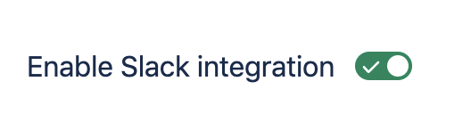

Can you please verify that the Slack is enabled as described here in the first comment by @Daniel Eads :
Unable to connect Slack to Jira Cloud
