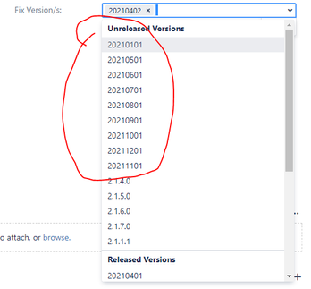

i need help to solve this ,
-when Fix versions/s field is edited  it should select values which belongs to circle ones ..see in below  picture
-if the option which contains " . " ex(2.1.5.0) is selected give error message "cant assign this fix version"  .
Nic Brough -Adaptavist-
August 12, 2021
You'll need to fix whatever it is that is checking for the . in the name and remove it so that you can add the valid versions.  Jira doesn't do this natively, so it looks like you have a broken Behaviour (as you mention that)
August 17, 2021
Hi Juan,
I am sorry, I am confused.  I think I have misunderstood the original question.
Could you help me out by describing what you are trying to achieve directly?  Instead of "this is not doing what we want" (which I have struggled with), maybe describe what should happen?
For example (and this is my next guess on what I am not understanding): In your screenshot, there is a list of possible versions to select from.  You would like to remove items from that list so they cannot be selected (even though they are valid)
August 17, 2021
Yes, shortening the list of versions can be done with Behaviours - this is the baseline script I usually start from when I am looking to do it: https://library.adaptavist.com/entity/set-behaviour-multi-and-single-select-options-and-value
However, I'm no Behaviours wizard, I don't know if you can do a condition of "for issue X" (although that does depend on how you want to make the decision - could it be based on the issue type as an easy example?  Something like "Can't select version 12345 for bugs")
