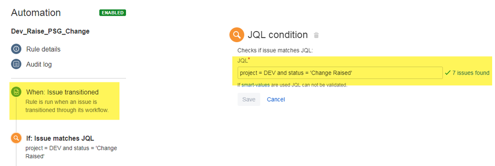

Here is the head of the rule:
Pretty simple, and I'm sure it was working...

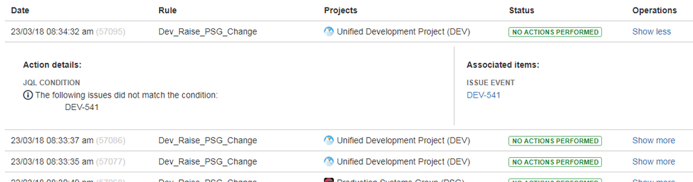

Here is an example audit log:
So the three 'No Actions Performed' are for a test JIRA issue in the DEV project going from:
Open -> In Development -> Dev Complete -> Change Raised as per history:
BrokenRuleHistory.pngThe status is definitely 'Change Raised', and the JQL works if I do an issue search...but the rule just tells me 'The following issues did not match the condition...'
The rule is set to 'GLOBAL', it is enabled...all other rules seem to work...
