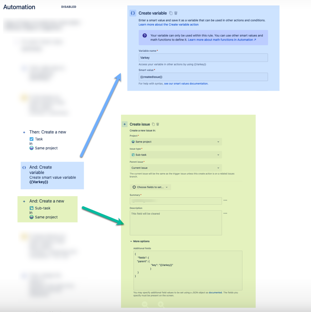

Allow me to answer your question here to help others as well. :)
The Additional Fields section is used to edit fields using JSON and not to create new issues. Usually, you can add a Branch immediately following the Create Task action. This branch can operate on the most recently created issue, and you can create sub-tasks there.
If you are already creating the tasks/subtasks inside a branch, you can't create a sub-branch. As a suggestion to create subtasks without changing the rule flow. You can save the parent task issue key in a variable and use this variable to update the parent field in the subtask. This way, the subtask will be created under the newly created task.
Here's a screenshot to illustrate this suggestion:
