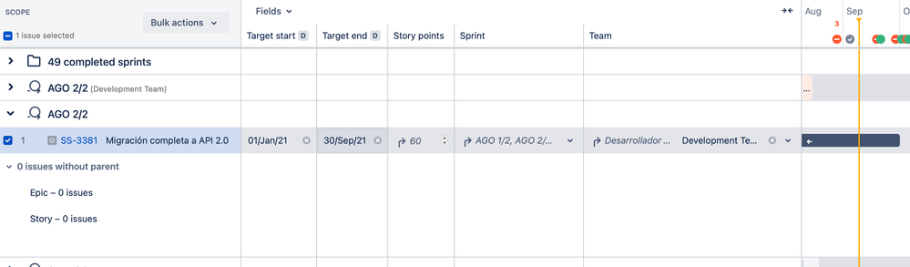

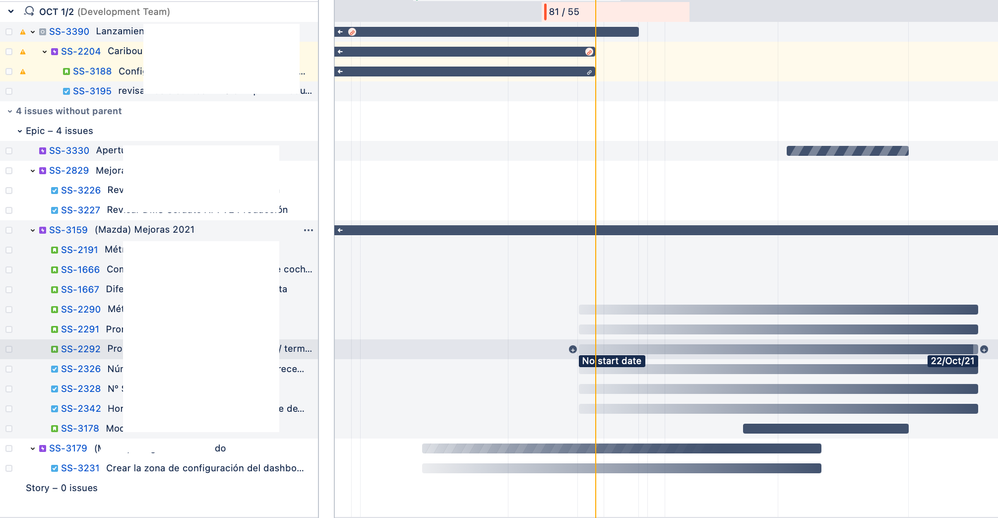

It seems I have a problem with Advanced Roadmap.
I have this Plan configured with two boards, SS and SIX. Each one come from a different Jira Project.
Captura de pantalla 2021-09-08 a las 10.22.32.pngCaptura de pantalla 2021-09-08 a las 10.22.23.png
There are 3 problems:
1) As you can see, the current sprint appears cutted, and as much as I struggle about it, I can't figure out why.

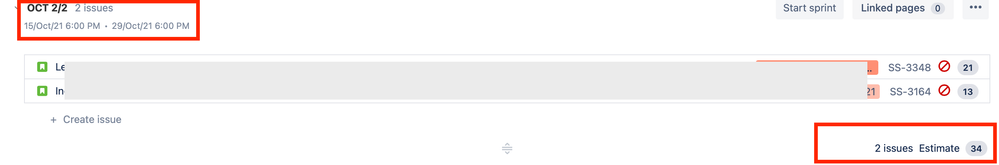

2) The sprints SP allocated don't fit with backlog sprint estimates: Look the examples of OCT 1/2 and OCT 2/2
3) Dates also don't fit: Look again OCT 1/2 and OCT 2/2.
Does anybody any idea about what's is going on here?? I'm going crazy :S

This is the flyout.
Regards.

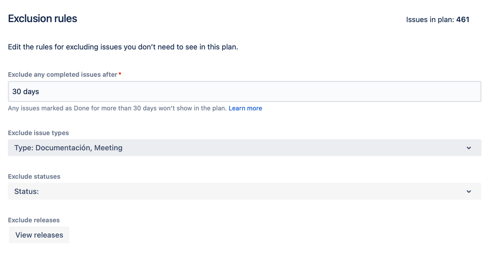

It is hard to tell without having access to your projects and backlogs, but I've seen something like this before and the answer was; due to the Exclude any completed issues after = XX days (in the Exclusion rules section of the plans configuration) the completed work wasn't considered part of the plan, thus the discrepancy.
In that case they had a very small completed window (only 3 days), changing it back to 30 days resolved the issue.

Hi Curt, and thanks for your reply.
I followed your advices and setup it in 30 days
It changed from 355 to 461 issues, but now the problem is still pretty similar. The view looks like that
The problem seems in SS-3381 goal issue. I've added it to the right team and no sprint, but nothing.

I notice in your Exclusions there are some issue types being excluded, that could be part of the problem as well. Try removing them from the exclusion list and see what happens

Hi Curt. I didn't but still nothing. Finally I've followed the Sara advices and I've opened a support ticket. Thanks for your help!!
