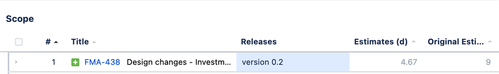

2. In Portfolio ("old view") there is an option to set/update both values - expected and ok
3. Advanced Roadmaps there is option to set/update Remaining estimate, but I don't see any way to add/update Original estimate. Also tried creating issue from Advanced roadmaps and entering only Remaining estimate - that results in Original estimate being empty. Is there any option to solve for this?

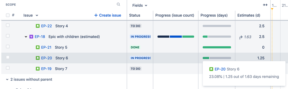

I would recommend that you add the the "Progress (days)" field to your plan as well as the "Estimates (d)" field.
If no original estimate has been set on an issue then giving the Estimate field a value and saving back to Jira will set the original estimate. It is not possible to log time spent on an issue through the plan (it is expected that this will be done on the issue screen) but you can view the progress of hours logged against the original estimate using the Progress field.
If you change an existing value on the Estimate field in a plan and save that change then this will set that value as the remaining time left to complete.

I hope this helps but please let me know if you need any additional information or if I've not understood the question properly!

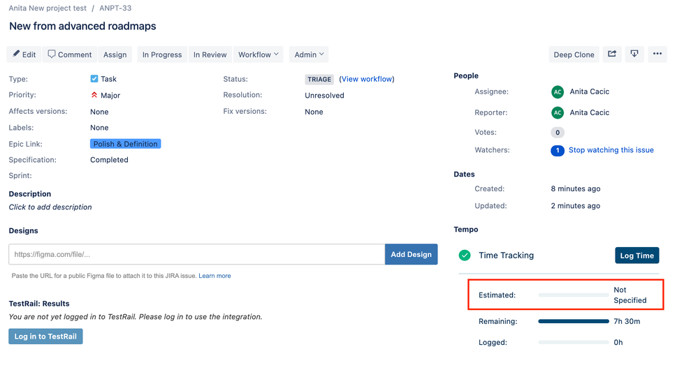

Here are my steps:
1. In advanced roadmaps created new Task and entered 1d in Estimates (d) field
2. In Progress (days) I can see 1 out of 1 days remaining and that is expected
3. When I commit changes and open the same issue in Jira I see that Original estimate field is empty
Can you please double check those steps?

Jira:

Having said that... I have subsequently noticed that you are absolutely correct that the "Original estimate" field (which I didn't have displayed on my issue screen) isn't being updated - the plan is only setting the time remaining (which is what is also used to initially populate the time remaining in the time tracking field).
So actually you're completely correct that the plan is not updating the Original Estimate field (I had just been focused on the time tracking field) - I got confused with how it works and I apologise for misleading you with my previous response - I'm so sorry!
