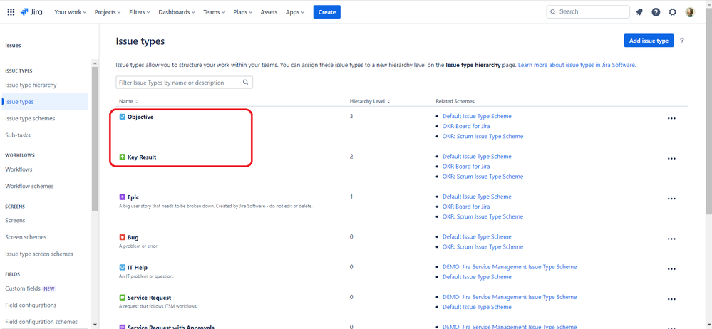

1) Initially the Objectives created through the plan (using portfolio) were visible on the plan under scope. I then committed the changes. But the next time I logged into the plan the Objectives did not show. Our JIRA admin found that the 'IssueType' of Objective, Key Result were not defined for those projects hence they were not showing up in the plan. After including those IssueType previously defined objectives still did not show up but the new defined Objective shows up every time. Does anyone know the root cause?

1. "Initially the Objectives created through the plan (using portfolio) were visible on the plan under scope" - you need to make sure that OKRs are above in the issue hierarchy. This way, the epics will contribute to the OKRs' progress.
2. "While creating the Objective, all projects do now show up in the drop-down" - the hierarchy works with company-managed projects, not the team-managed ones. So it may be one of the reasons.
