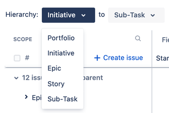

You can extend this with advanced roadmaps towards the higher level. So indeed, you can add an issue type Initiative and in hierarchy configuration add it at the level above Epics.
Once that is in place, you should see the full hierarchy available in your plan. It may look somewhat like this:
Even if your issues aren't linked together yet: if you see this hierarchy from the select options in your plan, you can be assured that at least your hierarchy configuration is configured correctly.
