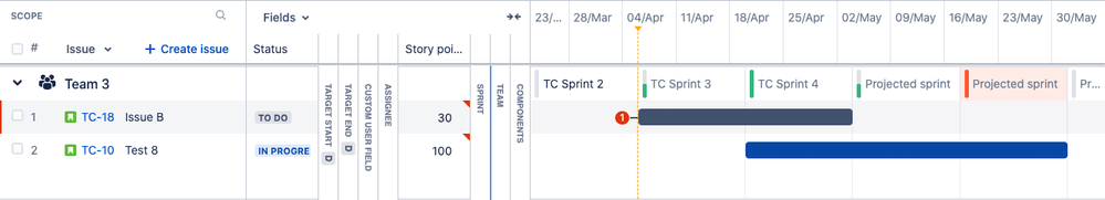

Here's a screenshot that illustrates this:
In this screenshot:
Hopefully it makes a bit more sense now?

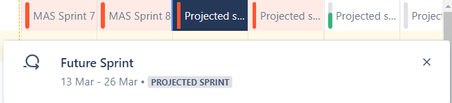

Below you can see the printscreens for the utilization of defined and projected sprints. In the past the projected sprints worked the same way as the defined sprints. Since v3.22 the projected sprints show in green how much the utilization is (not providing % or story points), when red there is no mentioning of how much the sprint is over-planned.
