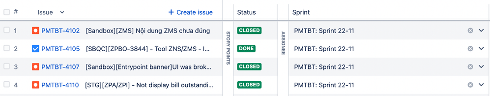

I have a problem when could not filter Done status for tickets move from others before sprint to active sprint.
For exp: Ticket A created from sprint 1 and it's done until sprint 2 hence its rollover from sprint 1 and sprint 2. However, I could not see ticket A when filtering active sprint 2 and Done status. Only see In-progress ticket.
It really necessary for us to check in daily what have done and what needs to be done.

I extended it to 120 days and it still did not appear. The problem is when I filter active sprint, all "Done" tickets created within sprint will appear even done or not. Only "Done" of rollover tickets did not appear.
We are facing a similar problem. Exclusion of completed issues is set to 90 days, but tickets that were in a now completed sprint before and went to another sprint, will never appear in Active Sprints after closing these tickets. It seems Roadmaps considers them being completed in the older sprint, which is not the case.
Assume Task A was in Sprint B -> Sprint B has been closed, Task A was not completed and therefore moved to Sprint C
Sprint C has been started, after the start, Task A has been completed ->
Version is Jira Data Center 8.20.17. Please help us. We want to use the Roadmap for Sprint Review and want to encourage our teams using Roadmaps. But with errors like this, we expect trouble.
