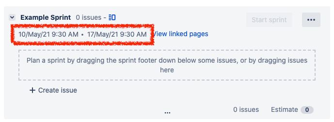

Hi @Mike Lemmon,
This will be dependant upon the version of Server (not Advanced Roadmaps) that you're using... the ability to configure future dates was added a while ago now though IIRC. The way to tell is to edit a future sprint from the backlog page and see if you have the option to set start and end dates for that sprint.
See these screenshots:
The UI looks very similar to when you start a sprint, but you can actually do this when editing any sprint even if it isn't active.
Dave

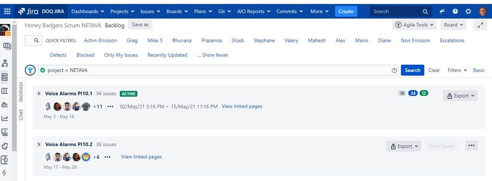

Hey Dave:
When I'm in our JIRA Backlog, the UI looks a bit different that what you have shown, the only Sprint that I can edit the Start, End date for is the Active Sprint .. as per the following screen capture.
Is there something I need to do to enable editing the Start, End dates for future sprints?
Thanks....
