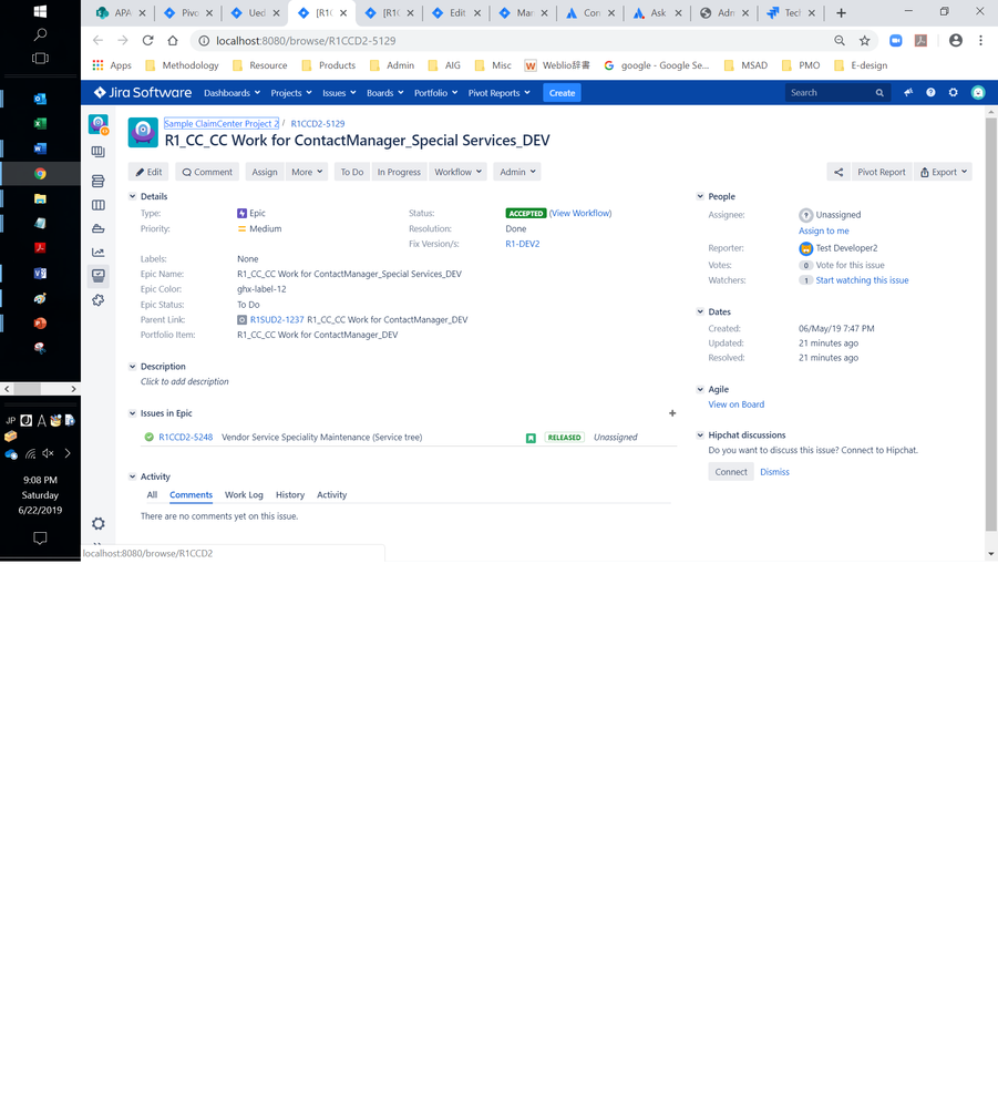

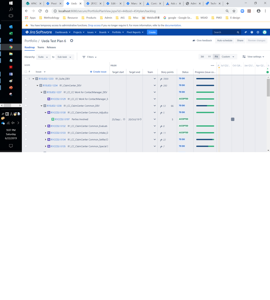

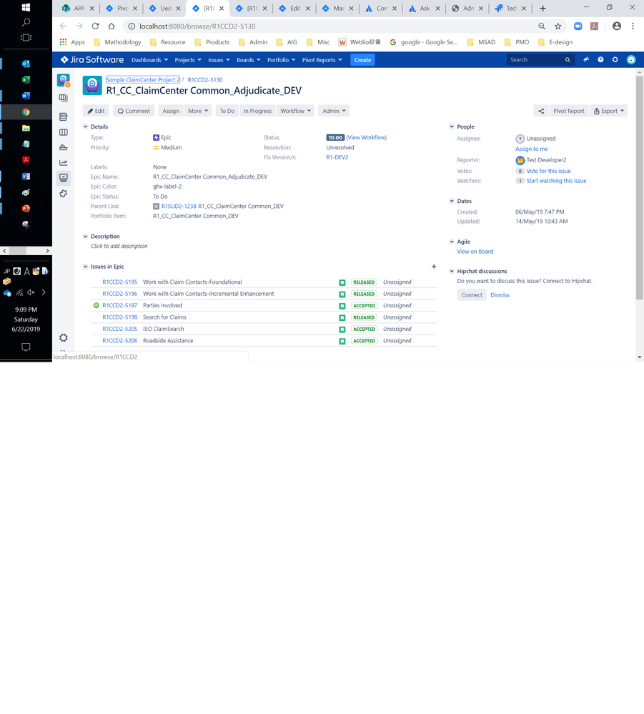

5129.png5130.pngPlan.pngHi,
I created a plan. (PFA)
You see epic-5129 has no issue, epic-5130 has one issue.
However, 5129 has one issue and 5130 has 6 issues actually.
This happens when I skip the status of issue - e.g. from To Do to Accepted.
Is this a bug?
We don't skip the status usually, but are sometimes forced to do so.
So I don't want to see this happen.
Teru

tueda June 25, 2019
Thanks Earl for the information.
I checked it but couldn't find similar case to me.
I don't set any filter other than release, but I don't change release.
I just changed the status of a story which is present in the plan.
If I change the status from To Do to Done, it doesn't disappear.
If I change the status from To Do to Accepted, it disappears.
So skipping status is not enough, skipping Done status seems the cause.
Does portfolio assumes something (which is changed when it's "Done" like the completion mark) in the story as the filter in a plan?
Hope it help.
