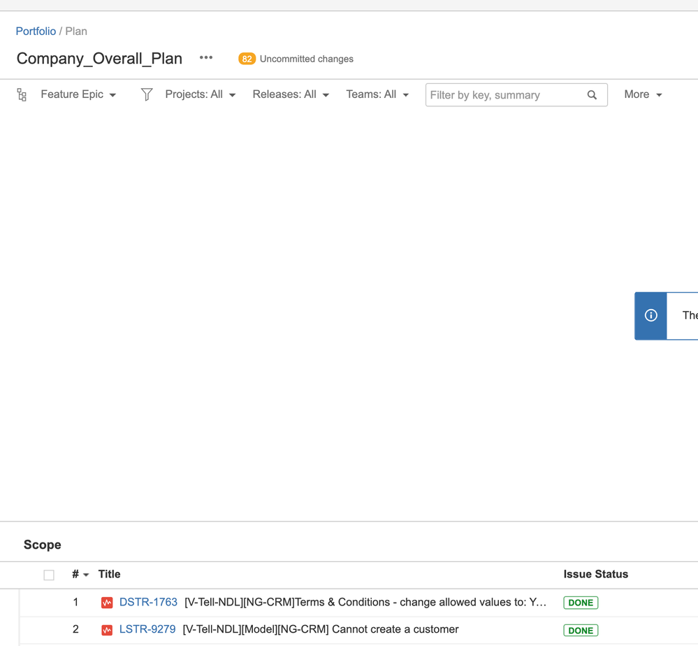

×Hi there,
i've setup a plan where i imported 2 JQL queries as they are business projects. in addition to that i've also taken 2 boards of our development teams as source because i wanted to schedule the stories into the real sprints.
with this second source ( the 2 boards ) i am getting a lot of other issues imported which i actually do not want to see on my scope, but i've definitely selected only this 2 feature epics which include the 2 business projects.
All of the additional issues are in status done, so not influencing my plan, but the big question is why they are there?
thanks a lot for your support on this.
cheers, Mike

Hi Earl,
they are showing up on both views, the live plan view as well as the New experience view.
the completion date filter is set to the default which means completed within the last 30 days
they do not have any child issues as you can see from the screenshot.
But the big question to me is, why they are showing up if i do not have selected them in the scope selection when i create the plan?
i would expect that issues which are completed within the last 30days within the selected scope would be still visible but not any other item which has no relation to the selection, isn't it?
cheers, MIke
