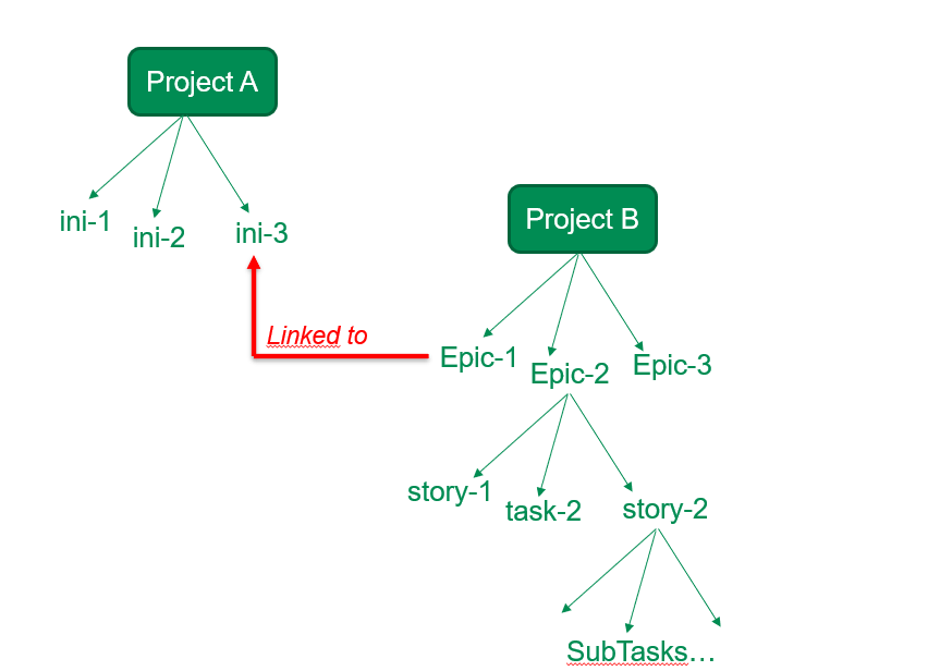

I have 2 projects :
I need a JQL query so i can list all items (Epic, story, sub-task) in project B for which the Epics are linked to the initiatives located in Project A.
Please help:)))

Hello thank you for the answer 😇!!
tjis still doesn’t help tho because I want all initiatives not only
in portfolioChildIssuesOf(INI-3)
Because this request returns only for one initiative, I want all issues ( in project B) that have a link to all initiatives (in project A).
please help
Thanks in advance 😇
Unfortunately I don't that there's a simple JQL solution for this @Exalya .... the only thing I can think is that you could create an additional hierarchy level above Initiative and then make it a parent of all the Initiatives in Project A and then use the portfolioChildIssuesOf for that issue. That's definitely a workaround to the problem but it should at least work.
