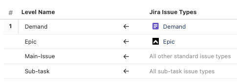

Hi there,
I hope someone can help as this is driving me crazy.
We are using on our DC Instance Advanced Roadmaps and the Hierarchy defined by me is not visible.
2. I added it as the top level in the hierarchy setup
3. I have 3 EPICs which I linked to a Demand and they are visible on the Demand as children
4.But for some reason the hierarchy is not visible in Roadmaps
I tried a lot of things already even including reindexing but nothing worked.
I even tried to create a Demand issue in the Roadmap view and attached the EPICs to it. It worked until I applied the changes to Jira, then the new Demand was gone and the Plugin even showed a message that this Demand is no longer visible.

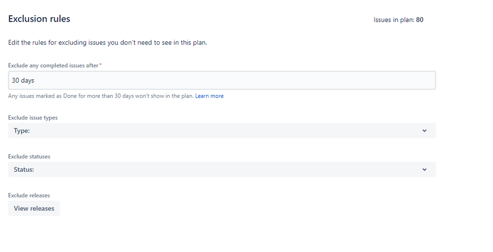

A few more questions...
1) Does all the issues (including the Demand issue type + all the childs of the Epics) are defined and hosted from the same IT PPM Sandbox project?
2) Can you check what you have in the Exclusion Rule setup to ensure that your issues are not be excluded from the plan.  Example -
3) What version are you using?  In our env, the configuration of the plan is the clog symbol next the plan name.
Best, Joseph

April 21, 2022
Here the Screenshots as I wasn't allowed to add them with the initial post.
