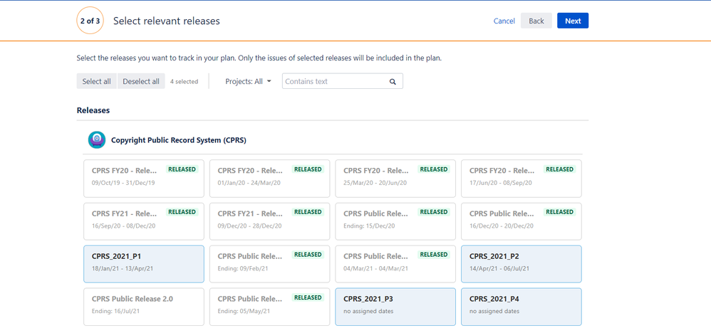

×I have created plan and in plan configuration selected the specific releases in "issue sources" from the boards that should be included but this is not working. In The releases tab - i have selected only few releases from the boards and expecting that plan should include only those issues but i do not see plan including those issues. THIS IS A SHOWSTOPPER for us as we only want to work with the issues in these releases in Plan. Looks like a product defect
No I am talking about configuration of a Plan. As you can see in the screenshot , It prompts to select releases from which issues will be tracked. But it does not include issues only from the selected releases. It randomly selects issues. This is clearly a product defect.. We use advanced roadmap version

screenshot of the screen where it asks to select releases from which to include issues is attached here -
Thanks for the screenshot, your plan should include all the issues associated with the selected releases (the blue highlighted ones) plus the issues which are not assigned to any release. If that's the case, it is the expected behaviour.
I agree that the text at the top of the page is a bit confusing. Currently, we are working to update the create plan wizard UI.
In our case - it does not include all issues associated with the selected releases. It includes a few but not all. We have tried several different ways but all the issues from selected releases are not included in the Plan. This clearly looks like a defect to us. This is not letting us use Advanced Roadmap as we are using it for Agile SAFe and would like ALL the issues from selected releases to be included in our Plan. This is a showstopper and is causing lot of angst to us.

Plan Configs -> Exclusion Rules is only for excluding issues from a plan. Meaning, you can only exclude specific releases. However, your plan will still include all the issues that are not assigned to any release.
To create a plan that only includes specific releases, you should create a new Jira issue filter and then use that as the plan issue source.
