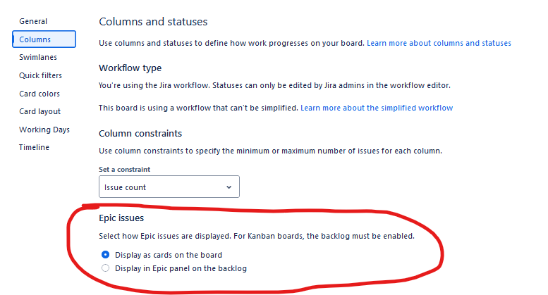

The second half is easier to fix. If you go into board settings, columns you'll find the two options. See the screenshot:

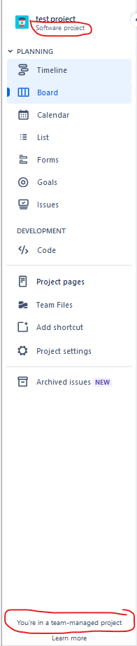

@Kristoffer Höeg I just realized I forgot to ask you what cloud subscription you have and what type of project are you using?
Don't know about the subscription, but it looks like my company is running a custom Lean Workflow Scheme. It's a development project.
It's a software project.

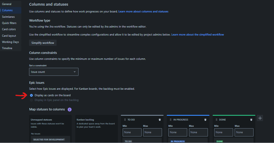

First, check your board filter, it's should include issue type Epic, Task.
Secondly, configured the board column, for example if you have workflow status for Epic, Task like Open, In Progress, In Review, Done then map the statuses to board column accordingly.
Third, select the option Display as cards on the board under Epic Issues in Board configuration.
Configuring above will show the Epic. If any Epic has Task then it will show the Task as well.
