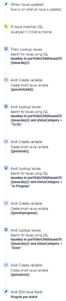

The link between a Initiative and it's Epic is created with the field "Parent Link" (of the Epic). I think this is a Custom Field that comes with Jira Advanced Roadmap (you need Premium Licences for this)
The trick is to use the magic query "issuekey in portfolioChildIssuesOf(PROJ-80)". This will return all issues in the tree under PROJ-80, without any hierarchy anymore. So you can check each issue 1 by 1 and process that information into an automation.

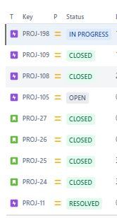

Under the PROJ-80, there are in total 5 epics and 4 stories (I masked the summary columns but you can see the type and status) This is the result of the quesry "issuekey in portfolioChildIssuesOf(PROJ-80)": a flat list of tasks without hierarchy
Note that Epics and Stories (and other tasks or subtasks) can be part of any project in Jira
So we see 7/9 are done (=77% should be rounded at 78%) and 1/9 to Todo (11%) and 1/9 is Todo (11%)
For the automation, here the steps :
I hope this helps you
