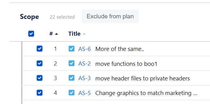

On the Scope Detail (the list of issues), to the right of the # sign, there's a checkbox. If you check it, that will allow you to set targets (like the original story points).

In the upper right hand corner, next to Calculate, you should be able to switch between Schedule, Capacity, and Target Schedule.
Select Target Schedule
Once you've done that, go ahead and select the issues again, and Set Targets should show up next to Exclude from Plan. I've included the link about Target Dates from the Cloud documentation below.
