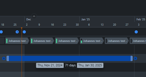

My team is working on three epics in parallel. This is now done over 5 sprints. But Jira Plans is currently allocating all sprint resources to the highest prioritise epic. And when that one is done it will allocate all resources to the next one.
This doesnt reflect reality in our case.
Image one shows how my three test epics is planned to be done at the same time. Picture two then says everything is allocated to TJ-60.
Similar case would be if there is only one Epic being worked on. I would like to be spread out in time. The image below shows an example where the Epic is finished before it "should be". This can be solved with sprint capacities of course. But wondering if there is a way to actually spread it out in time according to start and end date.

I was more or less assuming that that was your approach. It won't work that way, unfortunately. If you add issues to a sprint, they will be planned with start and end dates matching the start and end dates of that sprint. That is not possible if your issues are too large to fit in a single sprint, which is - almost by definition - the case for Epics.
A workaround might be to just use the start and end dates to schedule your epics on the timeline and remove the sprint allocation from them (they can't be added to a sprint on your scrum board anyway). That should make it possible to plan them concurrently on your timeline.
As you then start adding stories underneath and plan those in your sprints, the timelines you defined on the epics will start to act as a control point to see if you can still deliver them as expected. If stories get planned into sprints later than the Epic due date, you should see warnings appear in your plan about child issues exceeding their parent's due date.
Thank you Walter. I suspected this was the case.
The work-around you suggest is currently what we do. But that results in the images above, i.e not concurrenly. They are planned one after the other. I guess we will have to continue with this.
Once I start to add stories to the sprints everything solves itself. It is the long term (+6 months) that is currently my issue.
