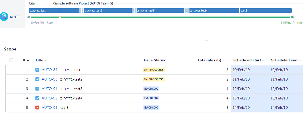

3. I have defined a working day as 8 hours, but when there are several short tasks (with less than 8 hours of work) are shown in the scope they currently work.
Attached is an illustration:
{In the attached picture, I have made the task conditional manually}.

For Point 3, the Lighter Blue highlight end caps on the schedule indicate dependencies on the issues that prevent one from starting before the next can start. Additionally make sure you have Team Members with available Capacity.

For your third answer -
I don't understand how it connected to the fact that task with Original Estimate of 3h is like a task of Working day (8 hours).
How do I solve this problem?

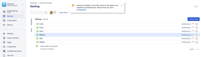

For an example on the ranking conflict that can occur, if you order say by Priority "project = RANKLESS ORDER BY priority ASC" in effect disabling the Rank, on the board the order is now defined by the Priority, and also Alphabetically. They are grouped together but you can no longer drag and drop to rearrange or you get this popup error (the data ordering is Static based on priority):

For the Dependencies, you are going to want to look at the "Dependent story constraint" by going to the plan Configure >> Scheduling, and set "Dependent story constraint" to Off, this will allow the Dependent items to be scheduled in the same sprint, and I would also recommend looking at and voting for the following Feature request as it details the current behavior and is asking for a more granular breakdown of this feature set that seems to fit what you are looking for:
