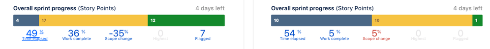

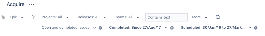

Screenshot 2019-02-06 at 09.22.36.pngWhen I tried to recreate the sources, Portfolio would not bring Done/Completed stories either.
So basically, it seems that portfolio is failing to bring them up (I repeat, the original boards show the completed stories, but the sources in portfolio using same boards would not)

With the help of the support team (at least the pointed it out to the right place), I noticed that some views in the reports ("scheduled range") were the reasons for my issues.
Problem now is that I need a lot of clicks to move from views to views to refine filters, because I am refusing to write target start/end date in the stories or sub-tasks

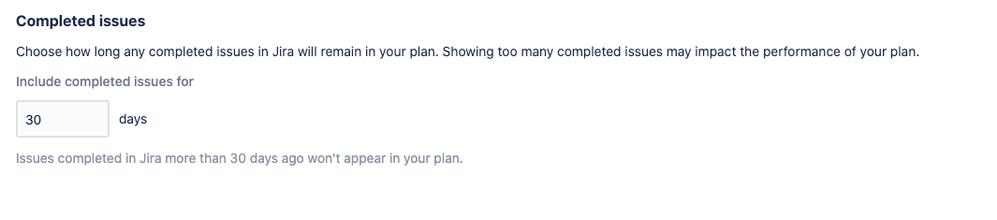

In Portfolio, there is section called completed issues in issue sources
So adjust it and see if issue solvesScreen Shot 2020-06-24 at 8.23.09 PM.png

I had same issue.  For Portfolio plans we use filters to pull data and everything but Done issues were appearing.  Running filter query from Jira you could see all the Done issues as well.  I went into the Portfolio plan and modified the Completed issues to be included to go back 365 days (you shouldn't need to go that far).   I saved and went back to the Roadmap and adjusted the date range using the custom setting and went back a few months.   Finally I refreshed Portfolio to reload data in memory with new settings and the Done items were now showing in the Roadmap view for the Plan.

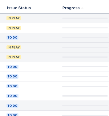

"Currently there is not information showing completion date in Portfolio however you may add Issue Status column under the gear/cog icon in the scope section of the plan itself.
In order to see the completed issues in the plan, you will need to ensure that all completed issues have a valid resolution value so that it will only display in the plan itself."

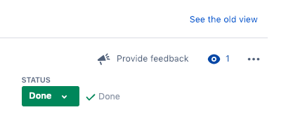

Jesus Fernandez February 6, 2019
if anyone else is reading, images are priceless
the moment the tickets are moved to done/done, then the issues disappear in the portfolio view no matter the options I select in the drop-downs, they simply won't show in the source feed when setting up the plan
