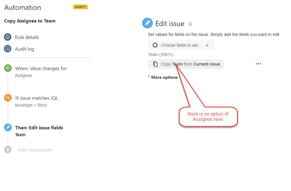

We are considering the following solution – create team per person and create automation that copying value from assignee filed to the Team field.
I tried to create this automation and it doesn't work. May be the problem is the different field type?

I understand the methodology of working with team, but in our organisation we set estimation per assignee… so as solution we decided to create team per assignee.
I’ve tried to create automation that can set Team from the assignee field then it edited… but the assignee field is not in the list of options… probably it’s not possible… maybe the type of assignee field does not much…

Team field (one used by AR for Jira) and Assignee field used by Jira Software/JSM are different data type and unique to itself. Assignee field is user picker and Team is not.
This is why you will have issue with automation rule setup. Even you setup the rule such as if assignee = a specific user, then set the Team to a specific value. It will not be scalable because you have to hardcode the different assignee to different team combinations + very difficult to manage it.
