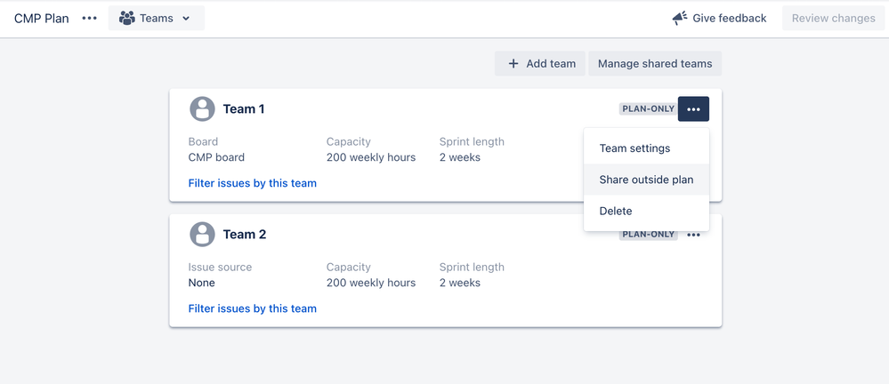

Hi @Nouf
For a Jira board to see what team has been assigned to an issue you need to use a shared team within Advanced Roadmaps. I can see in your comment you're currently using private teams - unfortunately these can only be viewed in the plan that created them. They won't be visible to other plans nor to any Jira boards.
Luckily it's really easy to convert your private teams to shared teams! If you access the "Teams" view of your plan you can use the "three dot" menu in the top right of each team to select "Share outside of plan". I've included a screenshot below.
From here you can now start creating the JQL filters for your Jira boards as you need!
I hope this helps - let me know if you have any issues and I'd be happy to help.
Cheers,
Daniel
Yes I did that and it worked now I can filter based on the team Thank you all for the support.
