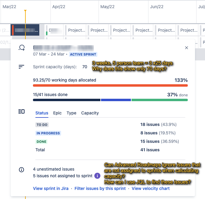

See the image below.  Assume:
  • 3 week sprint
  • 5 days per week
  • 5 person team
Sprint capacity should then be 3 * 5 * 5 which is 75.
Sprint capacity is missing 5 days here.  Where did the time go?

March 7 to March 24 is only 14 business days, not 15.
As 24 is a Thursday.
So 75 - (1x5 people) =70

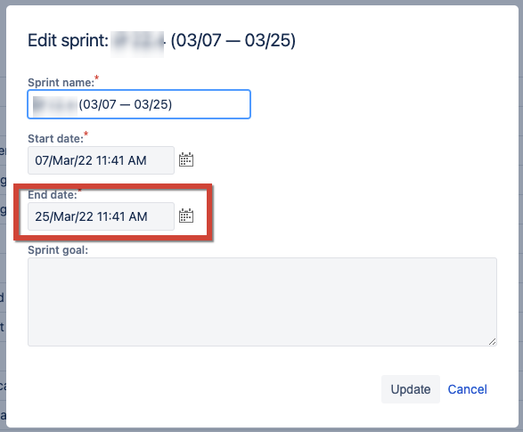

I see why I made the mistake.  You can't see it because the name of the sprint was blurred, but the sprint name had the end date in it, and it said March 25.  The sprint end date was chosen incorrectly.

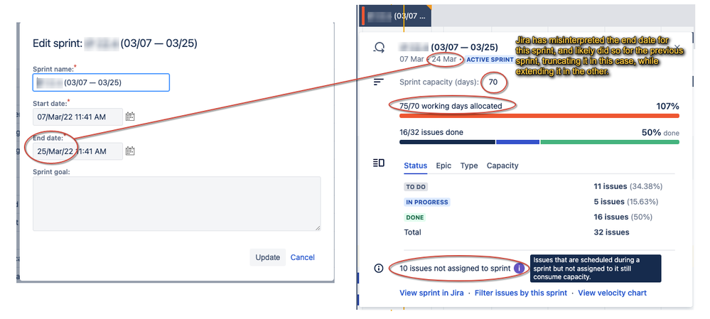

@Curt Holley Sorry, but I'm confused again.  The sprint ends on the 25th - why is Roadmaps showing the end date as the 24th?

Good question @Rob Horan I think it must have to do with timezones as I've got the same issue.
Like Advanced Roadmaps is on a different timezone to jira...or something.
What timezone as you on compared to Jira time, as I am out by 12 hours, so get these oddities from time to time.

What I have gathered is two things:
  1. Jira is consistently getting sprint date wrong, and truncating it, which decreases working days and also seemingly overlapping sprints.
  2. Unresolved issues from older sprints are rolling in with inferred start/end dates that are not part of the issue data, and therefore cannot be identified via JQL.

@Curt Holley - it's a bug.  I got this from support
After further investigating and checking with my colleagues Advanced Roadmaps considering the sprint as ending a day before the actual date set is currently a known bug:
I'm afraid I cannot give you an ETA on the fix. I suggest you add yourself as a watcher this way you will receive future updates on the bug, you are also encouraged to share your feedback there as this will help our team understand how it is affecting you. You can check more information on our Bug fixing policy at this link.
That being said a possible suggestion would be to set the end date of the sprint to one day after the actual date. You can continue to complete the sprint on the correct date as this will override the end date back to the correct date, but setting the end date to a day after could solve the last day problem.
