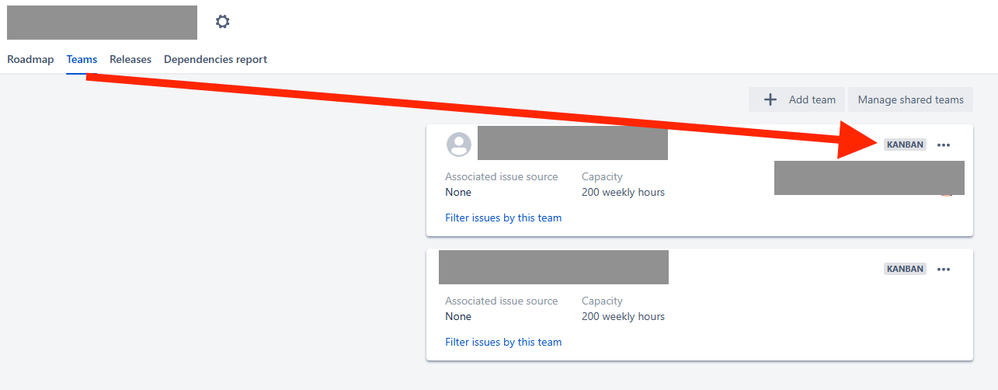

The Teams would be associated with the Plan. The Plan can have Plan-only Teams or Shared Teams associated with it.
From the Plan click on the Teams tab. Check each team to see if any indicate they use Kanban as the Planning Style.
