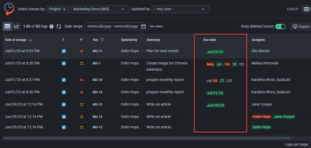

Try Issue History for Jira. It is a customizable report with all issue changes recorded in one place. The app helps to track updates for all standard and custom fields, each presented in a separate column. You can choose what fields to include.
Here is an example with due date changes:monitor due date changes.jpg

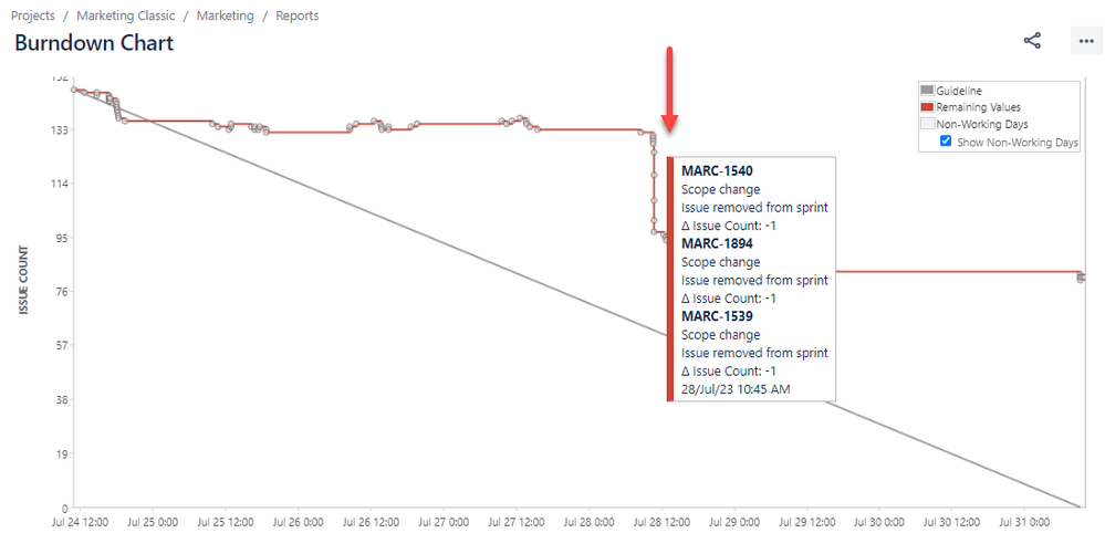

A good way to see how issues are moving in your project is Sprint Burndown Chart. It generally shows the work that was finished or moved to the backlog during each sprint. So you will know if your team is overloaded with tasks or underloaded.
If you hover the cursor over the red line, you will see what issue was added/removed/comleted during the sprint. Also, this information is available in the table below the chart.
