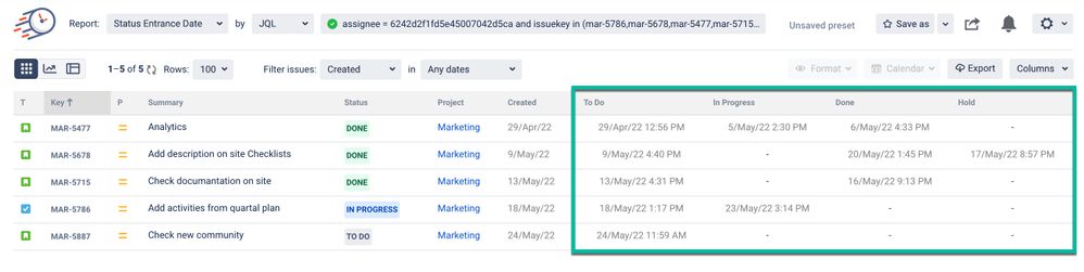

Status Entrance Date report in Time in Status for Jira Cloud
Time in Status for Jira Cloud app is equipped with different time reports that help to monitor team productivity. With Status Entrance Date, you may learn when an assignee began working on a task. You will see whether a user has entered "To do," "In Progress," "Done," or another status in this way. This information determines the precise date and time (10/Jun/22 4:22 PM).
How to configure:
  1. Choose Status Entrance Date report
  2. Filter issues by assignee, project, sprint, JQL, or other option you need.
  3. You can also select the date ranges for the data calculation.
Here is an example:
What other advantages you will get from Time in Status for Jira plugin:
  • Ability to get time spent in status without time tracking;
  • Table and chart view reports;
  • Gadget on Jira dashboard;
  • Wide range of pivot table options;
  • Use the Data Feed to integrate with 3-party apps like Power BI, Google Sheets, etc.

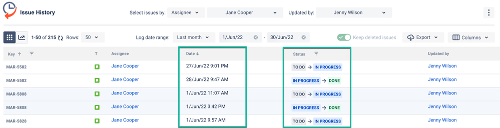

How to get Status Entrance Date using Issue History for Jira?
Issue History for Jira is a diary for every activity. It captures all changes at the issue level in chronological order.
To get the date when an issue entered some status, you need:
  1. Filter issues by Project, Assignee, Sprint, Label, etc.
  2. Choose the date range if required.
  3. Add custom and standard fields to the grid using the ‘Columns’ menu.
What other advantages you will get from Issue History for Jira plugin:
  • Organize any kind of historical report;
  • Search history activities without JQL;
  • Export issue history;
  • Track and store deleted Jira issues.
