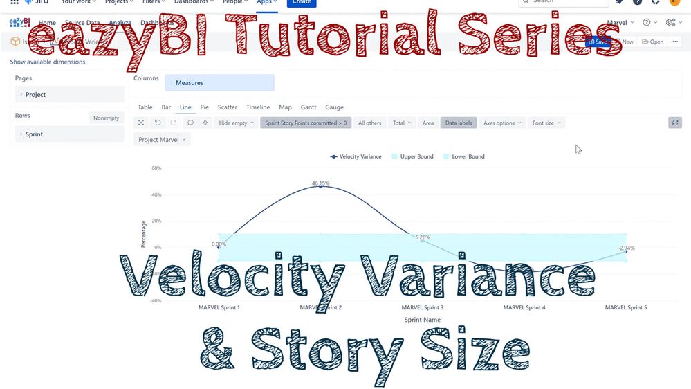

Overview
In this video you can find a complete walkthrough on how you can create the Velocity Variance and Story Size Charts with EazyBI:  Video Tutorial Link

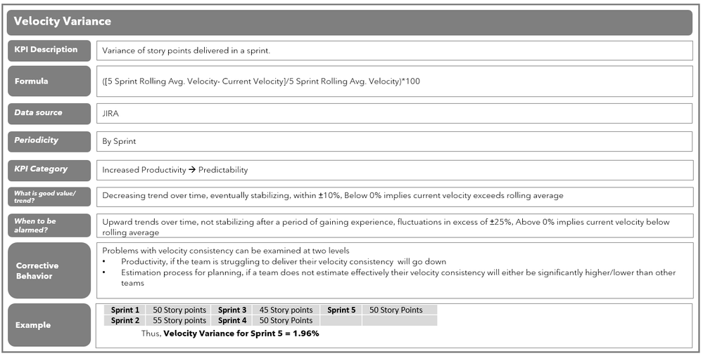

What is Velocity Variance?

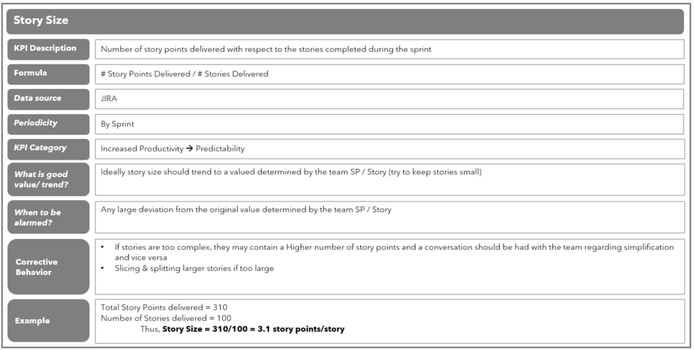

What is Story Size?
