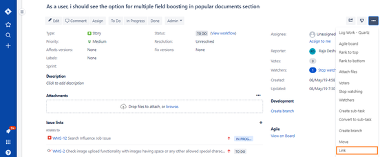

1] Open any Requirement with which you want to associate a Test Case. In the example that follows, Story issue types are mapped as Requirements.
2] Click on … > Link. The Link screen will appear, as shown below:
