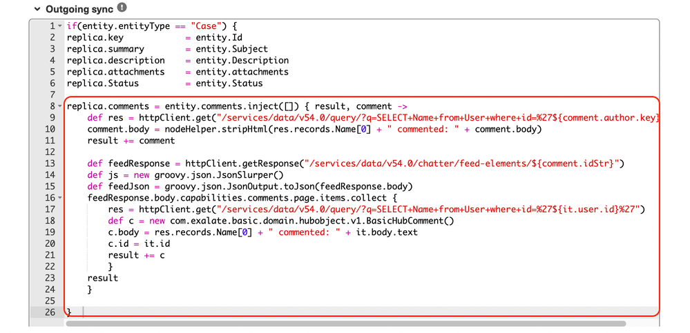

Salesforce: Outgoing Sync
if(entity.entityType == "Case") {
replica.key        = entity.Id
replica.summary    = entity.Subject
replica.description = entity.Description
replica.attachments = entity.attachments
replica.Status     = entity.Status
replica.comments = entity.comments.inject([]) { result, comment ->
    def res = httpClient.get("/services/data/v54.0/query/?q=SELECT+Name+from+User+where+id=%27${comment.author.key}%27")
    comment.body = nodeHelper.stripHtml(res.records.Name[0] + " commented: " + comment.body)
    result += comment
    def feedResponse = httpClient.getResponse("/services/data/v54.0/chatter/feed-elements/${comment.idStr}")
    def js = new groovy.json.JsonSlurper()
    def feedJson = groovy.json.JsonOutput.toJson(feedResponse.body)
    feedResponse.body.capabilities.comments.page.items.collect {
        res = httpClient.get("/services/data/v54.0/query/?q=SELECT+Name+from+User+where+id=%27${it.user.id}%27")
        def c = new com.exalate.basic.domain.hubobject.v1.BasicHubComment()
        c.body = res.records.Name[0] + " commented: " + it.body.text
        c.id = it.id
        result += c
    result
The Outgoing Sync script looks like this.
Here’s what happens in the script:
  • The inject method iterates over all the comments and performs several operations:
    • For each Salesforce comment, the script first fetches the username of the comment author and appends it to the comment body (so that it can be reflected on Jira as such). In addition, the script employs the stripHtml() method to transform the HTML formatted Salesforce comments into plain text to be properly reflected on the Jira side. We add this main comment to the result variable temporarily.
    • For each Salesforce main comment, the script then fetches associated threaded replies and populates them in the feedResponse. Each of these threaded replies is then sanitized by removing HTML and appending the author's name to the comment body. They are then added to the result variable.
    • This result, once the iterations are over, contains the main comments and threads that have already been transformed. It is then assigned to the replica to be sent over to the Jira side.

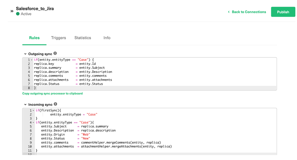

Salesforce: Incoming Sync
if(firstSync){
        entity.entityType = "Case"
if(entity.entityType == "Case"){
  entity.Subject  = replica.summary
  entity.Description  = replica.description
  entity.Origin   = "Web"
  entity.Status   = "New"
  entity.attachments  = attachmentHelper.mergeAttachments(entity, replica)
def commentMap = [
  "mathieu.lepoutre@idalko.com" : "0058d000004df3DAAQ",
  "syed.majid.hassan@idalko.com" : "0057Q000006fOOOQA2"
def flag = 0
replica.addedComments.collect {
    comment ->
    def matcher  = comment.body =~ /([a-zA-Z0-9._-]+@[a-zA-Z0-9._-]+\.[a-zA-Z0-9_-]+)/
    def newCommentBody = comment.body
    matcher.each {
        newCommentBody = newCommentBody.replace(it[0],"")
        def res = httpClient.post("/services/data/v54.0/chatter/feed-elements", \
        "{\"body\":{\"messageSegments\":[{\"type\":\"Text\", \"text\":\"${newCommentBody} \" },{\"type\":\"Mention\", \"id\":\"${commentMap[it[0]]}\"}]},\"feedElementType\":\"FeedItem\",\"subjectId\":\"${entity.Id}\"}")
        flag = 1
if (flag == 0)
    entity.comments = commentHelper.mergeComments(entity, replica)
The Incoming Sync script looks like this.
  • Remember that when sending comments from the Jira side, we replaced the user mentions with the email addresses. So, in Salesforce we create a mapping called commentMap that maps the email addresses to the corresponding Salesforce User IDs.
  • The next step is to iterate over the comments contained in the replica and for each comment extract the email address, map it using the commentMap and then replace the email address in the comment with the Salesforce mention of the mapped user.

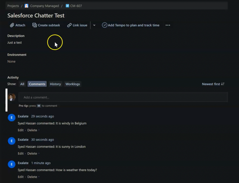

Output
Once the code is inserted into the respective outgoing and incoming syncs, comments, and threaded replies will automatically be reflected in Jira.
 So when you insert a threaded comment in Salesforce.
All of them get reflected in Jira.

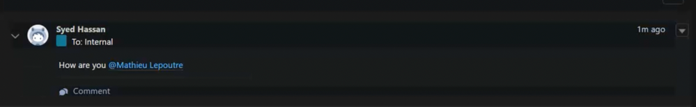

Also, user mentions in Jira will tag the corresponding user in Salesforce, if he/ she exists.
So mention a user in Jira.
And see the corresponding user being tagged in Salesforce.
