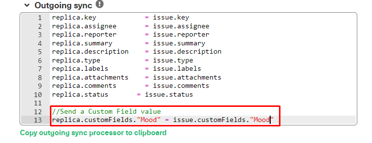

Under the “Rules” tab on the Zendesk side, enter this line of code in the “Outgoing Sync” text area:
replica.customFields."Mood" = issue.customFields."Mood" |
Note: The issue.customFields method contains the unique key for the Zendesk custom field. The replica.customFields method contains the key value you want to pass to the Jira side.

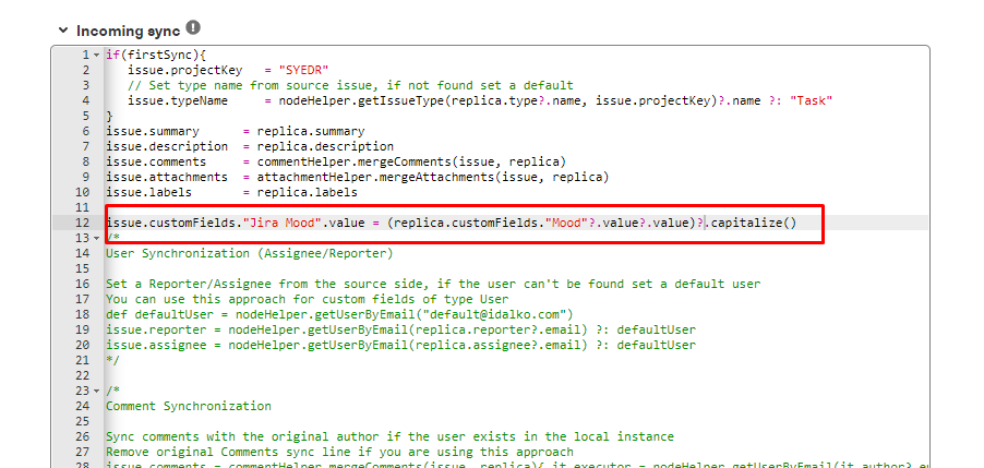

On the Jira side, enter the following code into the “Incoming Sync” text area:
issue.customFields."Jira Mood".value = (replica.customFields."Mood"?.value?.value)?.capitalize() |
Note: This line of code receives the value from the Zendesk custom field. The .capitalize() method converts the first letter of the received value into uppercase.

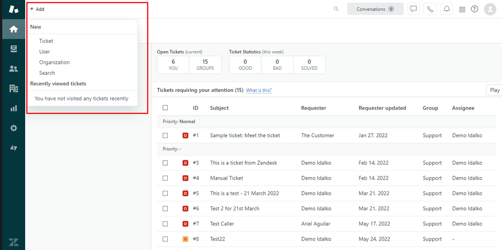

Go to the Zendesk dashboard and click “Add Item” to start. Select “Ticket” from the dropdown menu.
Enter a subject and description. You can also change the brand, requester, assignee, tags, and form. Then click “Submit as New” to save the ticket.

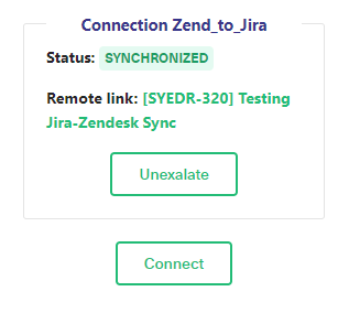

Go to the Apps tab on the right sidebar and click “Exalate”. Select the connection and complete the process.

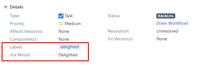

Once the sync is complete, the status will change to “Synchronized”. You will then see a Remote Link leading to the Jira side. Click on the remote link.
On the Jira issue, you will see that the label has changed and the mood has been updated.

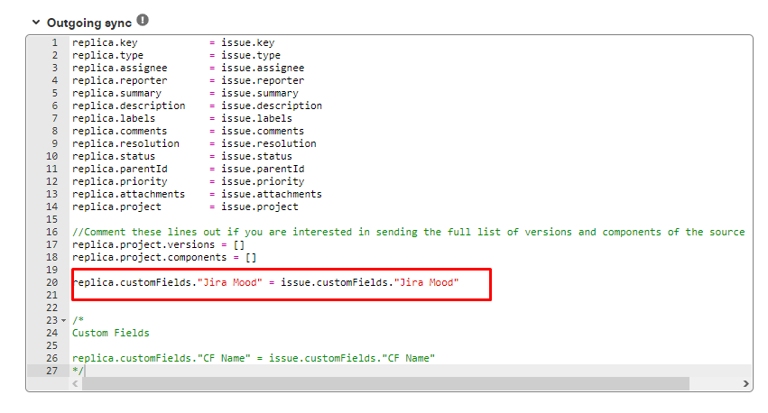

Open the console on the Jira side and adjust the rules in the Outgoing Sync textarea.
replica.customFields."Jira Mood" = issue.customFields."Jira Mood" |
Note: This line of code tells the system to send over the value of the “Jira Mood” custom field.

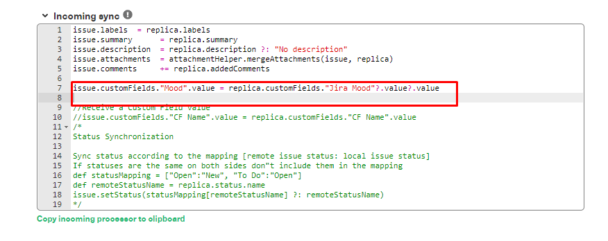

Then go back to the Zendesk side and change the config for the Incoming sync.
issue.customFields."Mood".value = replica.customFields."Jira Mood"?.value?.value |
Note: This line of code returns the (already capitalized) value from the Jira side using a slightly different syntax.
