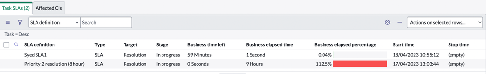

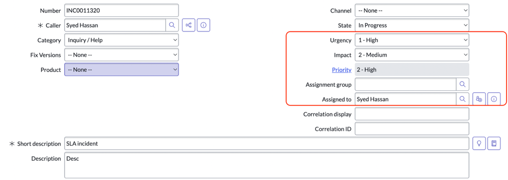

Begin by creating a simple incident.
Set it in such a way that it triggers two SLA records.
The incident priority is now high and assigned to a specific user. And SLA records are created.
Both the SLA records must be synced to the Jira instance.
After syncing, the Jira side looks like this.
