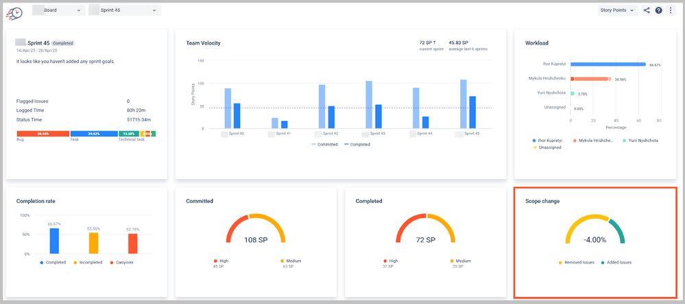

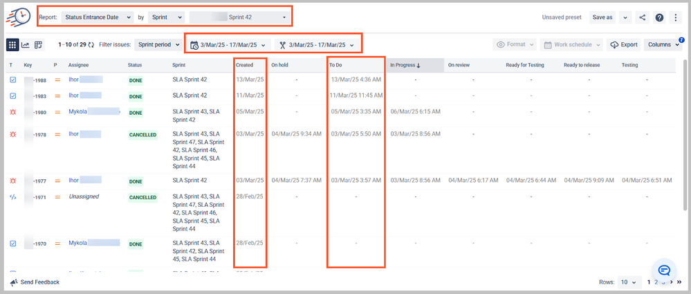

1. Preventing Scope Creep
Imagine a sprint starts with 20 planned tickets. But halfway through, 5 more appear on the board. Were they added to meet urgent needs, or was scope control not enforced?
👉 Use the Status Entrance Date report to flag tickets added mid-sprint. Combine with sprint filters to spot non-compliant additions.
Also, review the sprint report regularly to see exactly how your scope change score changes over time.

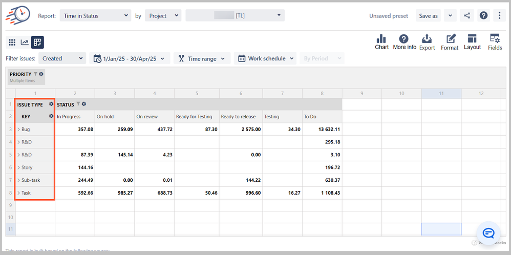

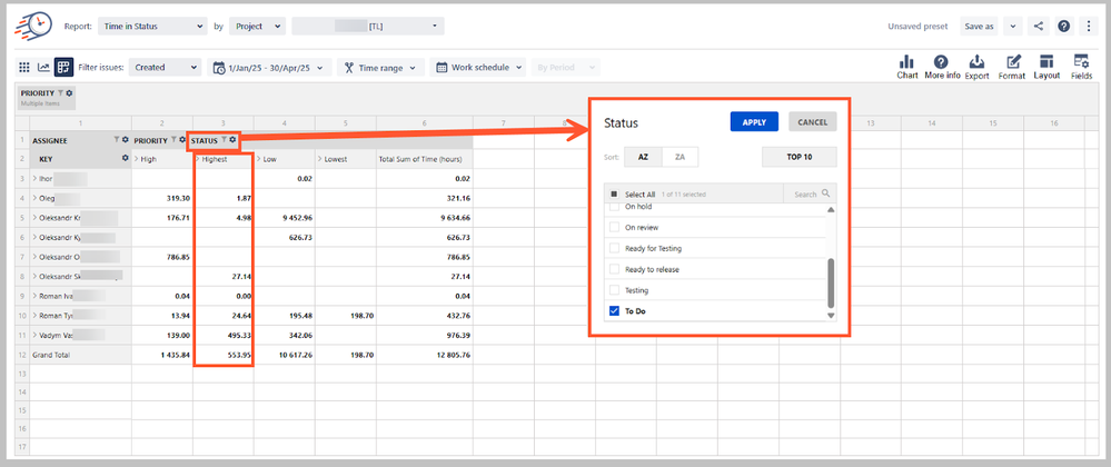

2. Measuring Backlog Aging & Responsiveness
Some work items sit in the backlog for months, while others are pulled almost immediately. This can signal uneven prioritization or reactive planning.
👉 Create a report to analyze the age of your backlog by task priority. This will help you assess whether tasks are being prioritized correctly and how quickly your team is responding to them based on their urgency.

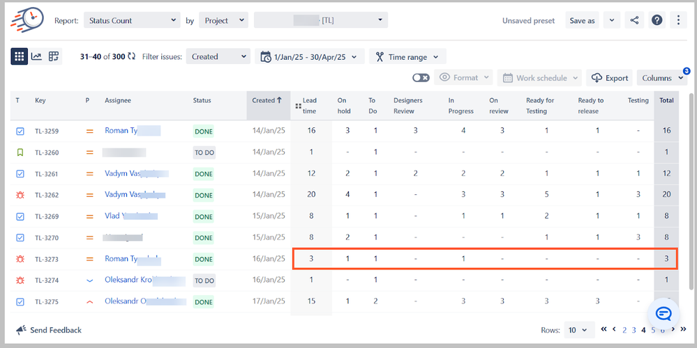

3. Auditing Grooming Effectiveness
If tickets move directly from backlog to development without touching statuses like “Ready for Dev” or “Groomed”, it may suggest teams are skipping critical prep steps.

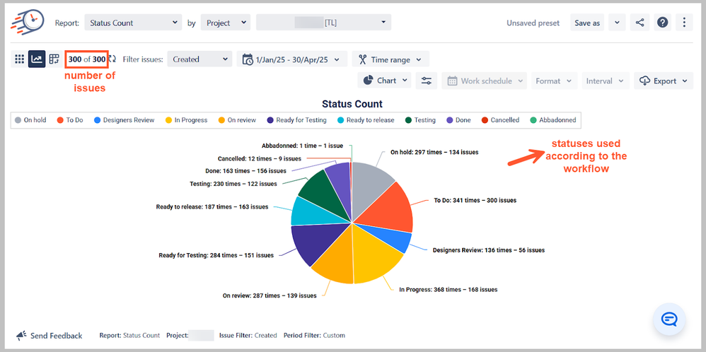

👉 Look for missing intermediate statuses in the Status Count report.  Teams can then reinforce pre-dev checklist compliance.

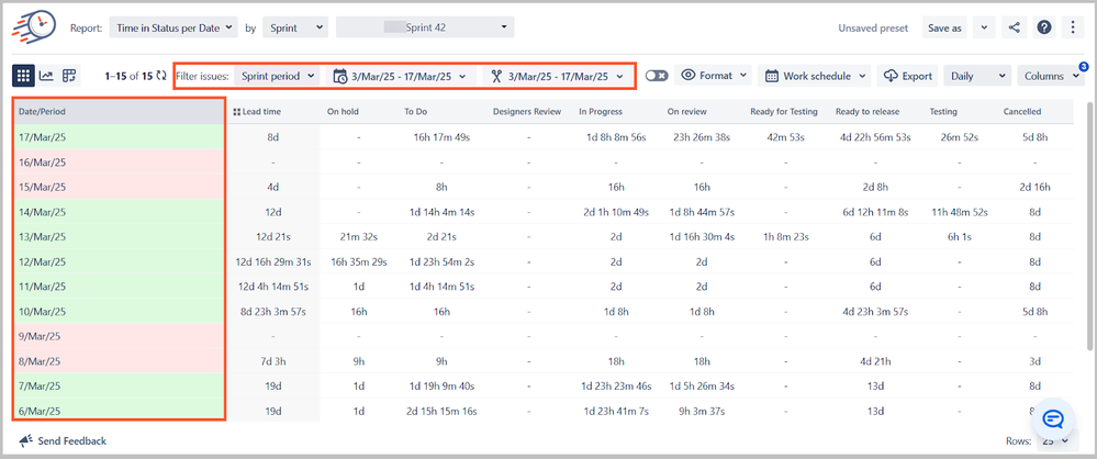

 👉 Use Time in Status per Date report to visualize daily activity trends.
Ask questions like:
a) Did most work start mid-sprint, indicating a slow ramp-up?
b) Were blockers only identified near the end?
c) Did we shift priorities mid-sprint, pulling in new work reactively?
With this report, you can overlay actual team behavior onto the sprint plan, making retrospectives more about workflow patterns, not just outcomes.
