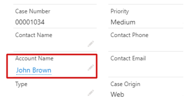

Now go back to the JIRA issue and change the SF Account to one of the options.
Back on Salesforce, you will see the Account Name appear automatically.
