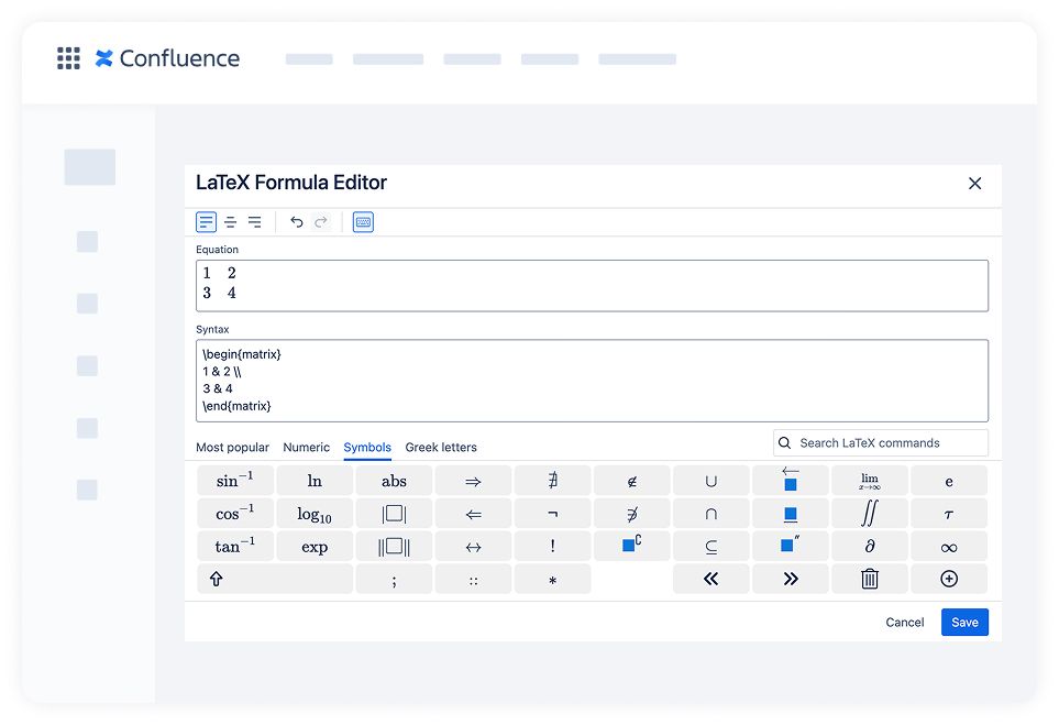

In LaTeX, a matrix is created inside a special environment that arranges elements into rows and columns. The simplest option is the {matrix} environment:
\begin{matrix}
1 & 2 \\
3 & 4
\end{matrix}
Here's how it works:
& separates elements within the same row
\\ starts a new row.
This code will produce:

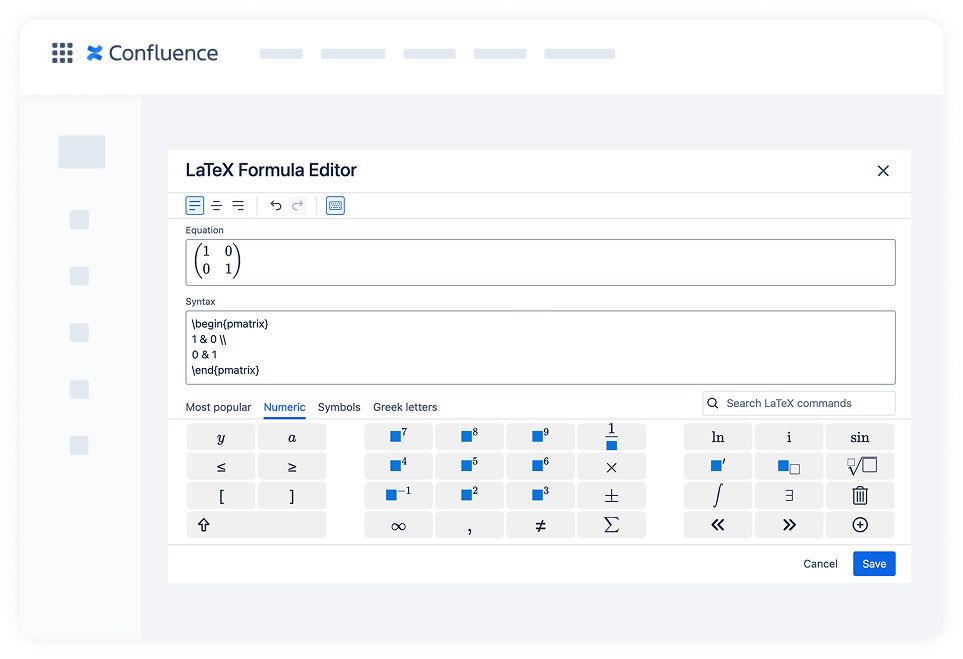

Example: 2x2 matrix with parentheses
\begin{pmatrix}
1 & 0 \\
0 & 1
\end{pmatrix}

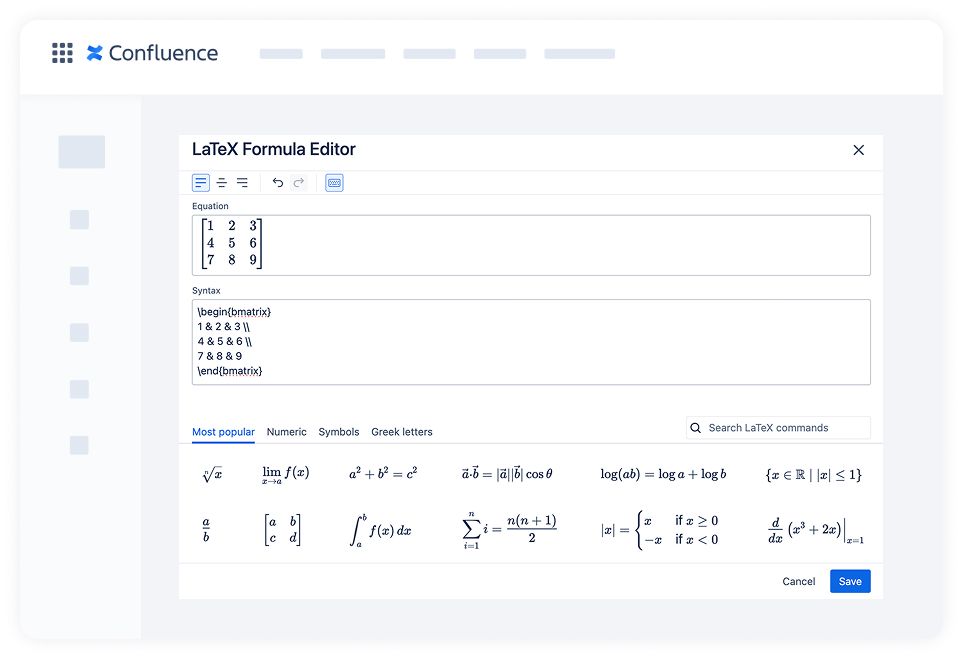

Example: 3x3 matrix with square brackets
\begin{bmatrix}
1 & 2 & 3 \\
4 & 5 & 6 \\
7 & 8 & 9
\end{bmatrix}
