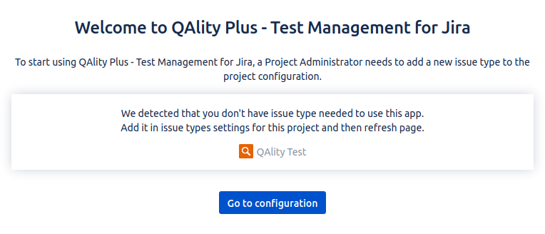

Configure issue type for company-managed projects
For company-managed projects on Jira Cloud and on Jira Data Center, you will be informed about the need to enable the “QAlity Test” issue type when you view any issue in your project. The following information shows up if you have not enabled the required issue type yet. Jira administrators can click on the “Go to configuration” to set up the QAlity Test issue type for the project.
The configuration should display currently enabled issue types as shown below. To reach this page you can also go to Project settings -> Issues -> Types. To edit your issue types, click on Actions and Edit issue types.
This will bring you to the screen that displays issue types in two columns. One column shows the issue types that are currently enabled. The other one displays issue types that are available, but not enabled. Move the QAlity Test issue type from one column to another, in order to enable it and then confirm changes by clicking Save. That’s it! The QAlity Test issue type is now enabled.

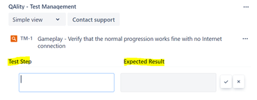

Step 3: All set
Once you have enabled the issue type, you should be able to create and manage test cases in your project. The issue view should have the following elements:
If you can see them, it means that you are all set to start using the app!
