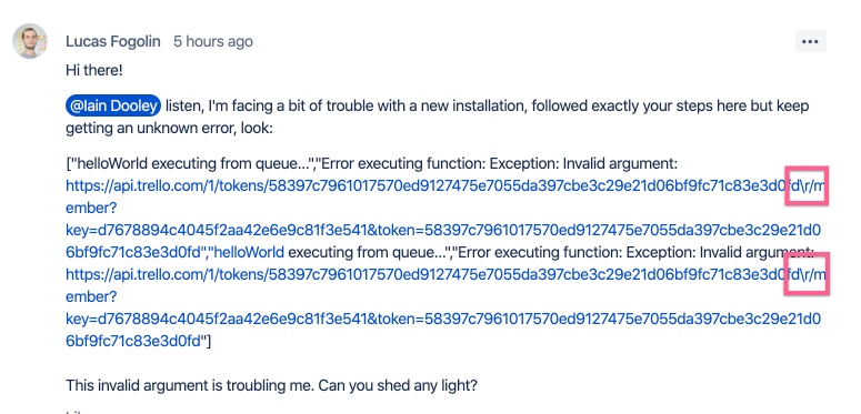

@Iain Dooley listen, I'm facing a bit of trouble with a new installation, followed exactly your steps here but keep getting an unknown error, look:
["helloWorld executing from queue...","Error executing function: Exception: Invalid argument: https://api.trello.com/1/tokens/58397c7961017570ed9127475e7055da397cbe3c29e21d06bf9fc71c83e3d0fd\r/member?key=d7678894c4045f2aa42e6e9c81f3e541&token=58397c7961017570ed9127475e7055da397cbe3c29e21d06bf9fc71c83e3d0fd","helloWorld executing from queue...","Error executing function: Exception: Invalid argument: https://api.trello.com/1/tokens/58397c7961017570ed9127475e7055da397cbe3c29e21d06bf9fc71c83e3d0fd\r/member?key=d7678894c4045f2aa42e6e9c81f3e541&token=58397c7961017570ed9127475e7055da397cbe3c29e21d06bf9fc71c83e3d0fd"]
This invalid argument is troubling me. Can you shed any light?

@Lucas Fogolin see that "\r" at the end of the token before "/member" in the URL? My guess is wherever you copied the token from snuck a carriage return in there, you just need to delete that from the configuration tab

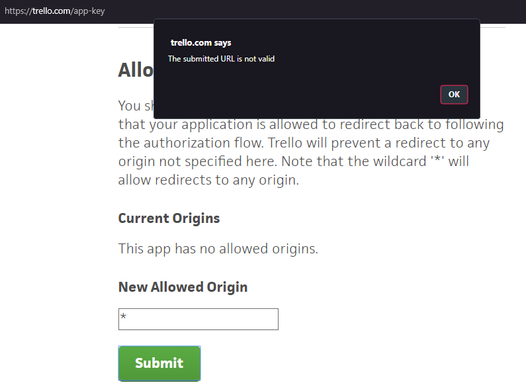

@Iain Dooley actually no, there's no '\' in any part of the key nor the token, but doing some digging In this new account, I realized that,different from my previous one, when I generate the API key the whitelisted URLs do not have the wildcard "*" and I can't add it there. Would, maybe its something to do with this issue? I took a print:
Iain Dooley
November 28, 2019
@Lucas Fogolin that origins thing is only for OAuth2 authorisation flows afaik. It's not relevant to Trellinator setup, I've never used it before. Have a look at this screenshot:
