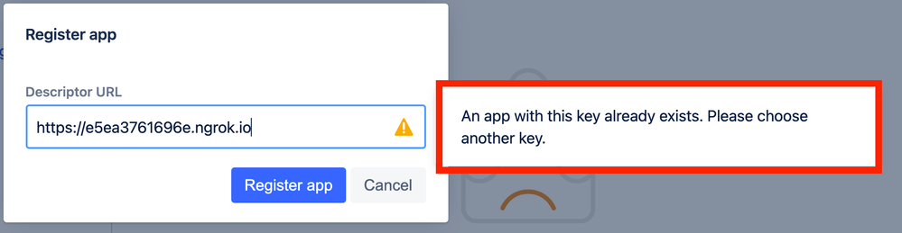

Choose register app and paste the ngrok url you copied earlier:
Push register app:
And I have an error that an app with this key exists. Change the app key in the atlassian-connect.json to a key which should be unique. For example, I made it like this:

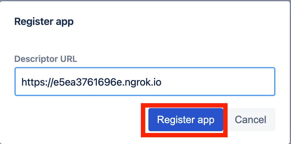

"key": "matveev-bb-test-app"
Push the register app button again. This time everything should work:
