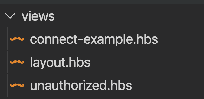

These lines tell us that our app will use Handlebars which is a template engine for html output. We can see that all templates are in the views folder:
The unauthorized.hbs template is used by atlassian-connect-express to provide errors if something wrong happened during calling our app module.
Other templates we will discuss later.
