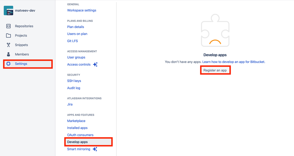

Now go to your workspace in Bitbucket.org and choose settings -> Develop Apps:

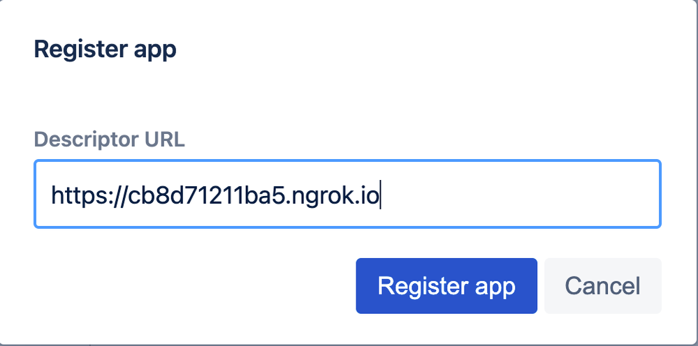

Push the register app button and add the proxy url from ngrok:

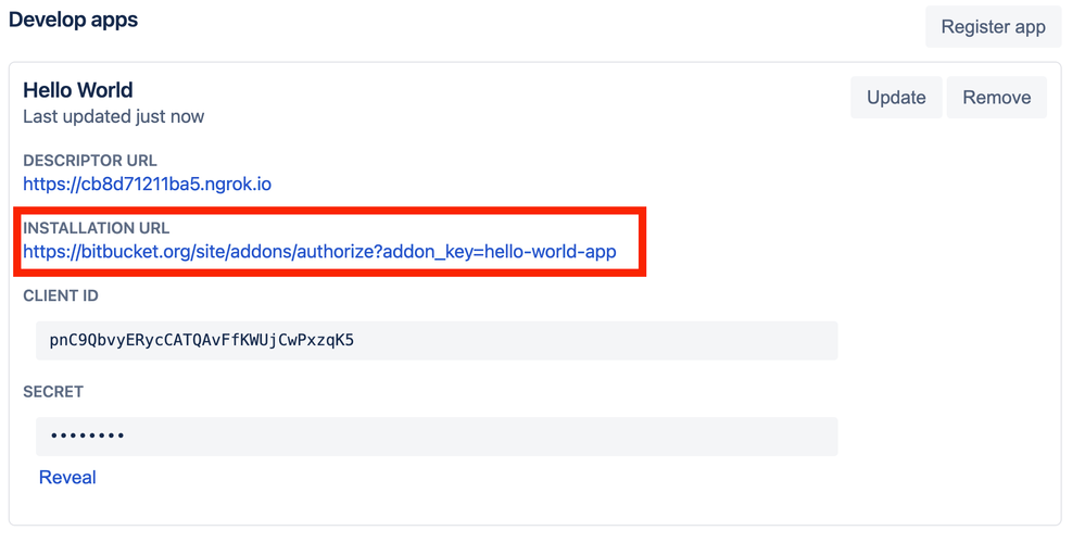

Push the Register app button:
Actually nothing happened yet on your app side. The client is not registered yet in your app. To register the client click on the installation url.

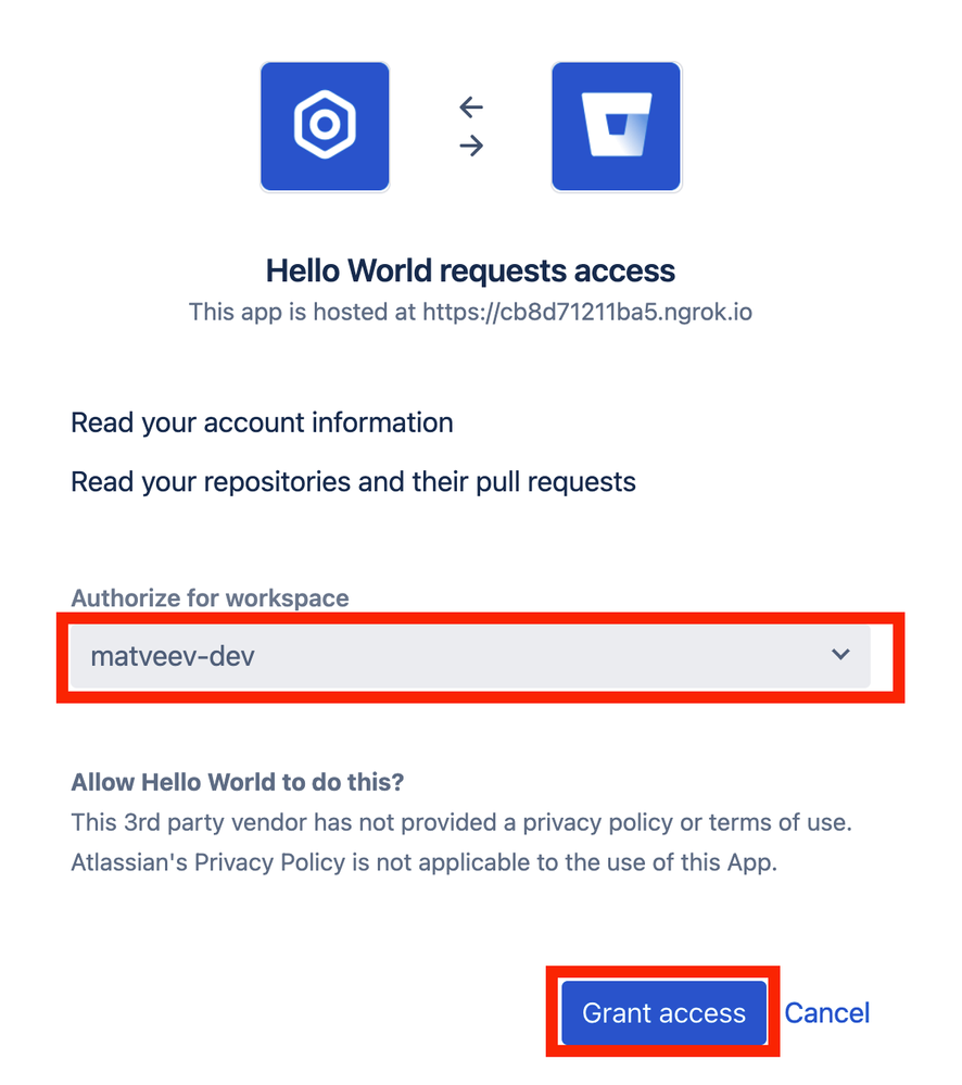

Choose the workspace and push the Grant access button:

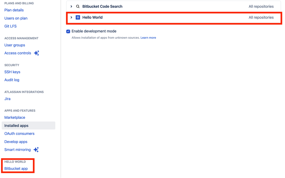

Now your app is correctly installed and your app has registered the client.

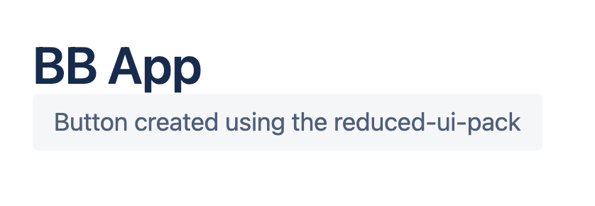

Click on the Bitbucket app link:
Everyting works.
