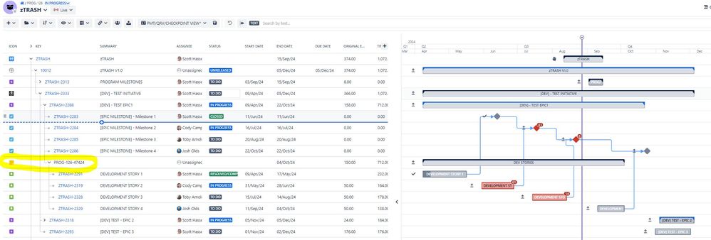

BigPicture/Structure: Is there a way to map a BP "Basic Task" to a Jira custom field
Scott Hassell August 28, 2024

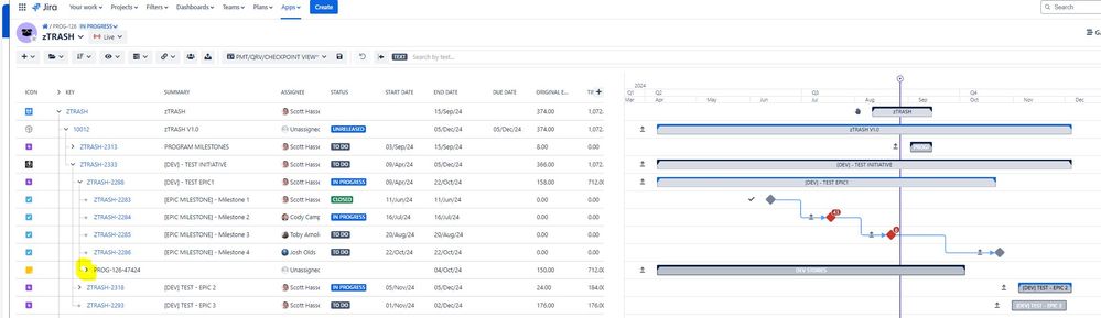

We would like to have milestones under an epic and collapse the dev stories.  We were able to do that by using a BigPicture basic task (see attached). However, most engineers use structure so we'd like a way to map to a Jira custom field so that we can create a structure with a similar dev story collapse as the BP exampleCapture 3 -  Structure View Dev stories.JPGCapture 2- Dev stories collapsed.JPGCapture 1 - Dev stories expanded.JPG

Hello @Scott Hassell
It's not clear what exactly you mean since no picture is attached, but using a Flex item can possibly be of help. It's a local item that can contain additional data other than just a name, and if needed - you can also convert it into a Jira issue later.
Additionally, you can use Flex fields if you need to be able to define custom dates to such items.
I hope this helps. If you need further assistance, please reach out to us directly at our support portal and we'll have a detailed look at your setup and requirements.

Scott Hassell August 29, 2024
snapshots now  added to the original question.
