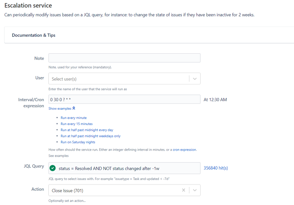

Hi @kousalya palagulla You can use project automation, if you are using Data Center.
An alternate solution is to create schedule Job in Script runner. Go to Manage Apps >> Scriptrunner >> Jobs >> Create Escalation Service
