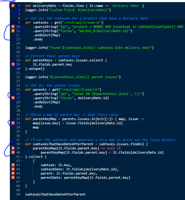

Let me ask you in regards to debugging. I got several errors after execution:
Is there good way to debug that you can recommend me?
Here an example of one of the errors I got:

Hi Javier,
Those "errors" are reported by our type-checking code which tries to report possible bugs in your code.
Unfortunately it can't always figure out what types are being used so unless we add in additional type hints we get these errors even though nothing is wrong. I've just become lazy with adding in the relevant type hinting.
The following code should not have those errors:
