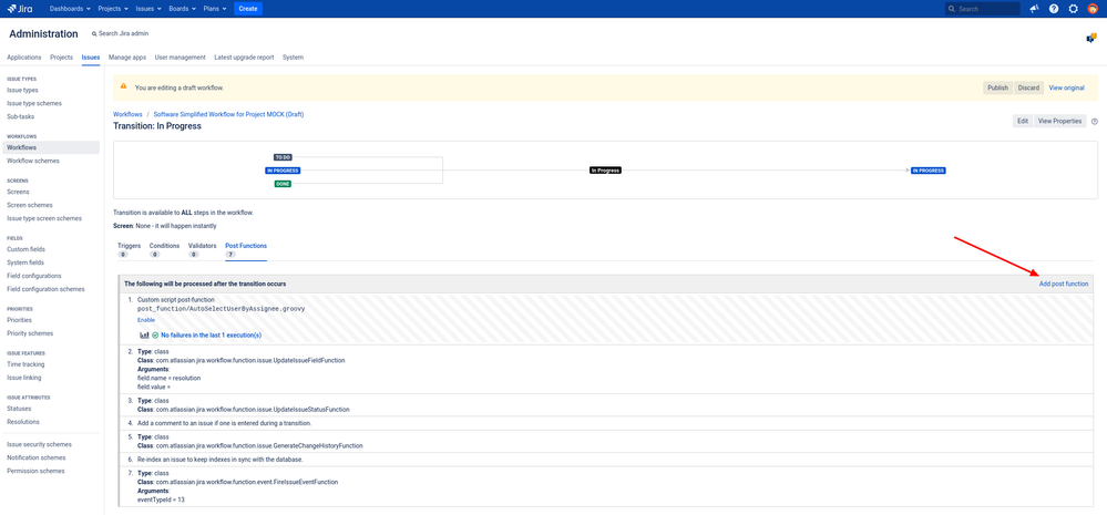

Below are the steps to configure the post function:-
1) Once you have selected which transition will trigger the post function, you will need to add a new post-function as shown below:-

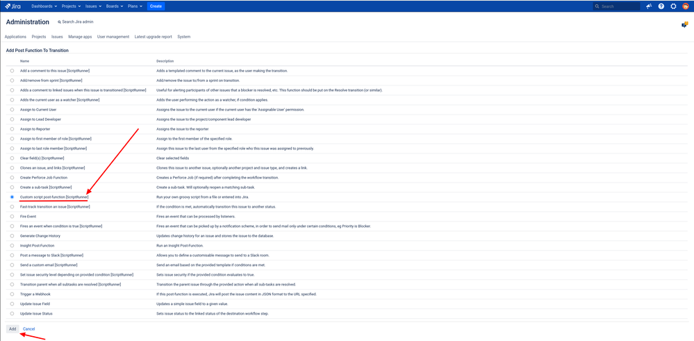

2) You will need to select the Custom script post-function [ScriptRunner] option and click the Add button as shown below:-

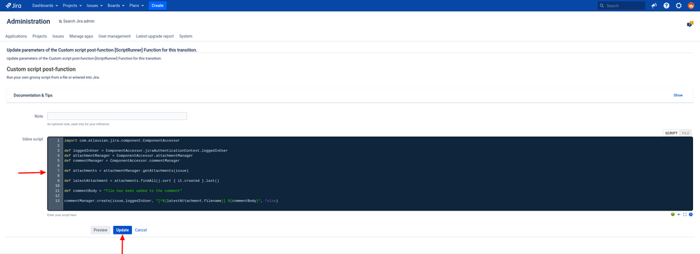

3) Next, add the sample code to the Post-Function and click on the Update button as shown below:-
Next, publish the changes.

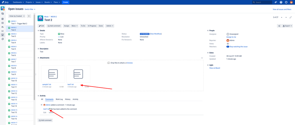

Below are a few test print screens:-

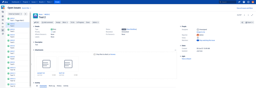

1) First, add your attachments to the ticket as shown below:-
here the test1.txt attachment was added after the sample1.txt attachment
2) Next, to trigger the Post-Function, the issue has to transition to In Progress as shown below:-
as expected, the last file is added to the comment.

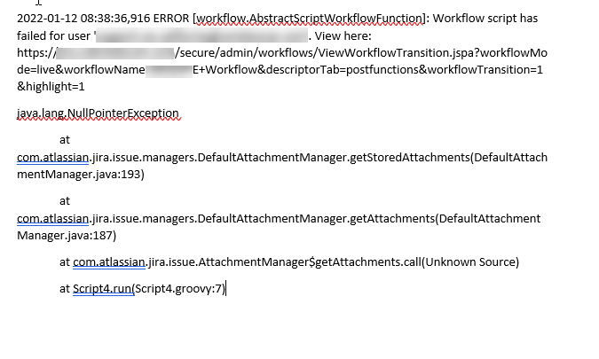

Hi Ram,
It is actually failing to run for me, I have attached the failed log if you help I would appreciate it
From the error message that you have shared, if you have not made any modifications to the code, it appears to be complaining about line 7 of the code, i.e.
def attachments = attachmentManager.getAttachments(issue)
You need to double-check if that issue has any attachments. If not, then it is expected that that error message will be returned.
Please share the updated code that you are using.
