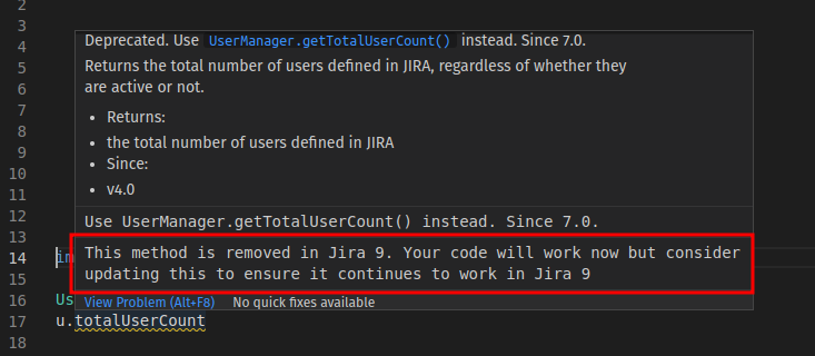

As Peter-Dave said, the script registry should help you. If you upgrade a non-production copy of your production instance (you are probably doing this anyway as part of your upgrade procedure), then go to Script Registry, in Jira 9 the removed methods will be marked in red.
In your production Jira 8 instance, you should see warnings for the methods that will be removed, as AFAIK all removed methods have been deprecated at least since Jira 8.
We know that not everyone upgrades and tests with a non-production instance first, so we have been trying to find ways to let people know they are using code that will not work in the next major host version.
So from the next version (6.55, which should be released on Weds 11th July), the editor will show an additional warning for those methods that will be removed in Jira 9, on Jira 8. This will generally have a deprecation warning alongside.
These warnings will also be shown for file paths in the script registry.
We toyed with making these errors rather than warnings but felt it would be too noisy. The other option we may look at is adding an "upgrade mode" to script registry, where this would be an error and not a warning. If you combine that with the new toggle which allows you to filter on only those scripts with errors it should be relatively easy to find them.

I would recommend looking for the deprecation warnings (amber warnings in the script registry and editor). I completely appreciate this is not straightforward if it's slow to load, or if you also have false positive errors (eg using dynamically-typed code that we can't properly type-check). I'd do this rather than checking every single removed method, the vast majority of which there's a vanishly small chance of anyone using.
A suggestion: For our purposes, loading the scripts all on the registry page isn't particularly useful since I won't be editing the scripts on that page anyway
No indeed, but everything there has a link to where it can be edited, so you could open the affected ones in a new tab and edit there.
> Something like a "Scripts Affected By Upgrading" page with just a dropdown to select which upgrade you're migrating to and a go button that then lists affected scripts and their soon-to-be removed/deprecated items seems ideal
I think something like this is the way we will go. We have discussed an approach along these lines, really what we are putting out on Weds is just a start to help early movers to Jira 9. There will be more to come hopefully.
Also note that the mouseover should show documentation for the method/field which has the information of what it should be changed to.
